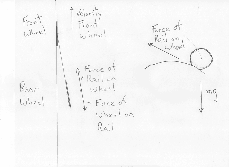

Suppose the rails were wide and with no crown and consider the following,
When you are peddling as long as the rear wheel does not follow the path of the front wheel there will a component of the force from the rail on the wheel pushing it towards the front wheel path.
Now add the crowned rail with the wheel off center, the weight force will now have a component tending to move the rear wheel away from the front wheel path. Add a wet rail and stability becomes more of a problem. With the pulley problem I don't know if the same "steering" effect comes into play?
I will have to think more about when you are coasting how the forces change on the rear wheel.

It seems to me that the mechanism can be explained as follows. The bike receives movement energy only when the right or left pedal is pressed. In the interval between pressing the pedals, the bike moves by inertia. Thus, in this mechanism, during the time between pedal depressions, the system moves by inertia and since the center of mass is in the front part, a stabilizing moment acts on the bicycle frame, which aligns the rear wheel on the rail. That is, the cart pulls the frame by inertia and the wheel aligns.
So long as the front of the bicycle is positioned above the centre of the rail, the rear wheel will follow in a pursuit curve, close to the centre of the rail.
