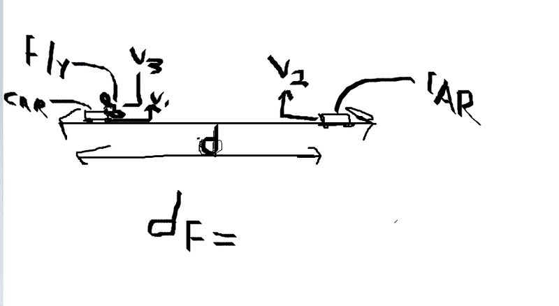

You have two cars traveling on a course to crash into each other, a fly is on one of the cars. The question is how much distance does the fly cover until the cars crash?
V= velocity,t=time
Df=?
p/v1,v2
lets say the cars are traveling at the same speed
This is a sketch of the problem

Your diagram shows three velocities. Please explain what those are and post some attempt.

Did you draw the diagram? If so, you must know what the three velocities represent.
Are you sure you've left nothing out? If you haven't, why would the distance the fly travels be any different from the distance the car it is on travels?
My teacher drew this diagram ( it was the only thing that was on the board for hw) and the he did not say what any of the variables were,so i just said 10 so i could understand the problem better but i had no luck

Could this be the following puzzle?:
Two cars with velocities v1 and v2 are on a straight collision course a distance d apart. A fly on one of the cars flies toward the other at velocity v3 which is greater than either of the car's velocities. Upon reaching the other car, the fly instantly turns around and heads back toward the previous car. This repeats until the cars collide. What is the total distance the fly flies before the cars collide?
