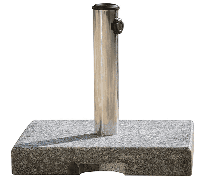

Here's the project: I have 50lb slabs of granite that I attached a poles to in order to make a railing alongside a walkway. The railing will be mostly for visual control and not to support a lot of force. I can make it any height I want but I want to get an idea if it could be used for crowd control at a rock concert
So I think what you are really asking is how much force will it take to *start* tipping over the railing (because once started tipping, it will keep tipping if the force is perpendicular to the post, which is what it will be if somebody is leaning into the fence and it starts tipping over).
Can you show the dimensions of the slab? That will determine the Center of Gravity of the slab and the moment arm of tipping it with respect to the ground. It's a simple equation after that.
Yes, I should have made it more clear that I was looking for the INITIAL force to lift the slab. The dimensions of the slab are 10"x10"x1" as shown on the image. But I don't understand why the 3rd dimension of the slab (depth) is needed. As long as we know it's 10" from the pivot point and 1" thick with a given weight, why would it matter if it were 10" deep or a mile deep? (I also understand that the 1" height would need to be considered but only has effect after initial motion has taken place, no?)
Oops, sorry. I have a short memory. :smile:
The depth makes a difference because it raises the COM (center of mass) above the ground by some amount. That changes the angle of the COM with respect to that lower left contact point with the ground, and changes the moment arm length of the force on the pole.
But let's just do an approximate initial calculation to get you going. Let's ignore the 1" thickness and use the 5" horizontal distance between the pole and the fulcrum point at the lower left of the base, and let's just use the vertical height of the force point on the pole with respect to the ground.
Torques are the product of the force multiplied by the lever arm length (assuming that the two are orthogonal (at a right angle), just like when you use a torque wrench. So the torque required to start lifting the 10" slab that weights 50 pounds is approximately (50 pounds of force with a 5" lever arm):
$$ \tau = 50 * \frac{5}{12} = 20.8 ft-lbs$$
Then the torque that you apply with your horizontal force some distance up the pole is that force multiplied by the vertical distance from the base. To see what force it takes 3' up the pole to generate that same torque, you would do:
$$ \tau = 20.8 ft-lbs = F * 3$$
$$ F = \frac{20.8}{3} = 6.9 lbs$$

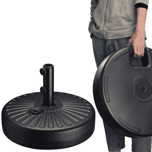

The base I found in post #21 is 15" square and 55lbs. So how much force applied horizontally from a height of 30" would be needed to START this base tipping?
71/2 inches from the base still seems quite small, if you really have worries about it being knocked over. I don't think this has been suggested yet but a very wide, thin base and a narrower, heavier weight in the centre. Maybe a hard white plastic, say 15mm thick. Hardly a trip hazard if the edge is chamfered. That would mean you could probably get away with less weight, which would allow it to be moved easier.
On the topic of ease of movement, umbrella stand bases are very often circular so you can tip them and roll them about. Not an issue if the post would only be moved twice a year. Cutting and moulding circles is slightly more difficult but anyone can use a jigsaw and concrete is good for any shape and you can layer it like Gym weights. Hey, that would mean you could dismantle it so that you could move it and store it in pieces. "How strong do I feel today?"
Edit: I didn't answer your specific question about Force
Roughly ( because the angles could vary) you have
Force = (weightXhalf base)/post height
= 55X7.5/30 = 13lbs approx.

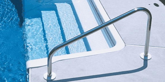

Every time I sit and think about this problem, something else comes up. For instance, there has been an assumption that the base of this thing should be symmetrical. In fact, the 'people-facing' side of the base could be much narrower than the pool-facing side. An almost L shape has advantages. It would give almost twice the restraining force for a given mass, especially if the mass is concentrated near the post.
@wysocki is there a real problem with anchoring these posts in the decking? If they need to be removable, then they could be slotted into permanent holes? I'm thinking of upside down top hat shape with the flange screwed onto the ground. Taking the post just a short distance below ground level would give as much control as you wanted. That's a bit less convenient for DIY than the concrete base idea but it would clearly be a better Engineering solution and could easily be made to look better.
Re-reading your past posts, I now realize that a rail by the pool steps will be used in a far more rigorous way (not by you but by swimmers who expect regular pool step rails when they pull themselves out of the pool).
I think this thing has to be 'over-engineered' to be safe.
