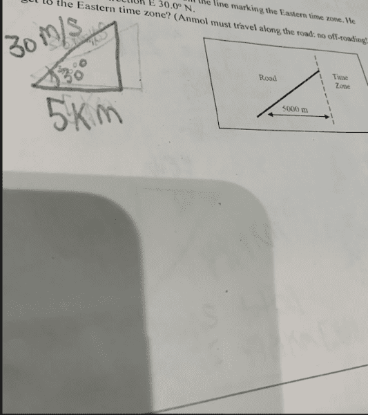

Here's my diagram I drew and the picture that came with the question. Also, to get from m/s to km I would assume you should multiply by 3.6?

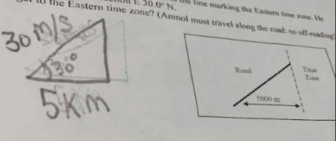

Okay, a couple of things. Speeds and distances have different units so there's no direct conversion between them. There has to be a "conversion constant" of some sort. In this case speed and distance are related by time: d = vt.
In your diagram you should label the hypotenuse with some variable representing the unknown distance, say D. The angle and horizontal distance labels are fine. Now, what can you do to find the value of D? What do you know about the lengths of the sides of a 30°-60°-90° triangle? Or perhaps you know some trig relationship?

Well, the trig functions are all based upon the ratios of side lengths for right-angled triangles. If you remember your high school geometry you might recall that there are a few triangles with certain angles that have well-known side length relationships. The 30°-60°-90° is one of them. But feel free to use the trig functions, too.

The unknown distance D is the hypotenuse. 30 m/s is the speed at which the car drives along that distance. How long does it take to drive a distance D at speed V?
You should review your trig function definitions to find one that involves your known (given) side length and the unknown side length.

Sort of but I'm not sure if it is right. I did 5 cos 30 which would get me 4.33, which I am assuming is the hyptoneuse? I'm not sure if this is right tho.
Nope. Look up the definition of cosine. What's the ratio?
