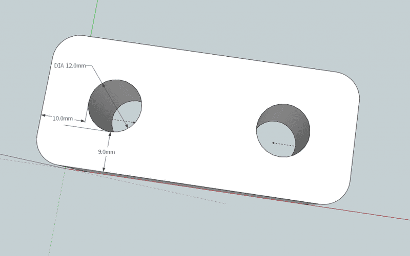

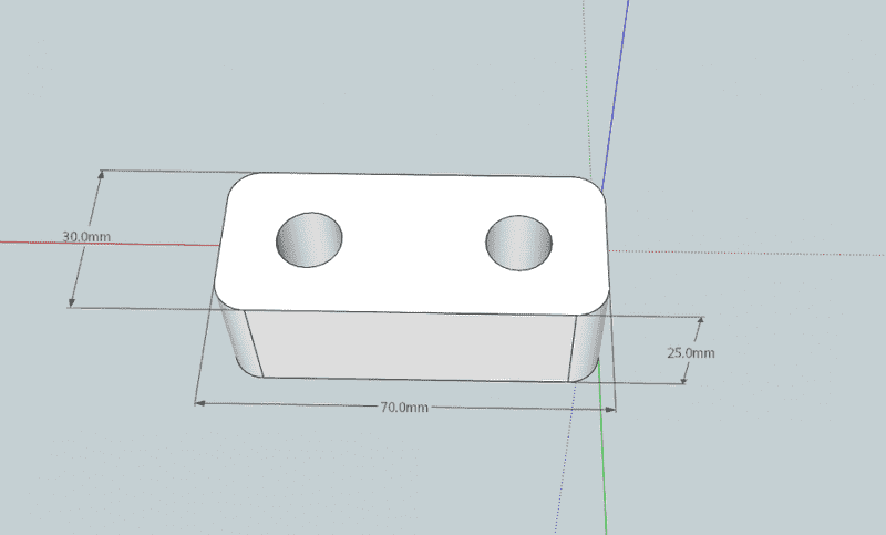

Hello everyone, this is my first time here and I was wondering if you could help.
I would like to know if there is a way of calculating how much weight this simple component could hold. It will be made from mild steel.
TIA

Can't tell how much this piece will hold ... there's no diameter shown for the holes nor their location relative to the sides of the piece.
Sorry, forgot to add those in. Here is an amended pic.
Is it possible to calculate now you have dimensions?

Now for a quickie eyeballing (which you should never ever do without testing the part afterwards) calculation.
The thinnest section is a cut out through a hole and has a surface Area of 25*(9+9)=450mm^2.
Now the worst construction steel in the world S185 (there could be something worse than this) has a Yield Strength of 175-185N/mm^2.
That would give a 8 metric tonnes. So With a safety factor of 4 (as clearly you will be next to it in use) you could say it has a maximum strength of 2 tonnes.
All the above are with loads of assumptions.
Because Engineering is more about practice in hopes of avoiding the math, never use a part in a life threatening situation that has not been subjected to failure testing. Not sure how considering the strength of it.
Also if you know your mild steels yield strength you could do the math again and get a more real result.
