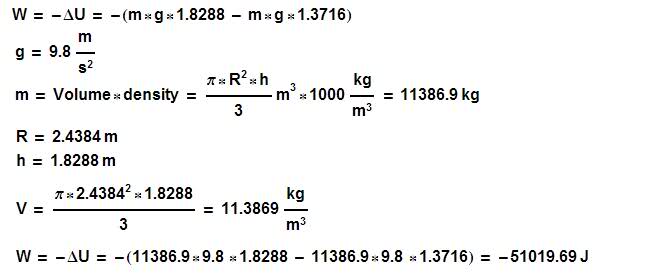

Dick, the integrand is somewhat complicated to put here, Mathematica won't let me copy it for some reason, but the problem was, ok I have a differential disk... its mass would be calculated with density = mass/volume?
tim_lou, the first option seems easier... I determined that the center of mass is a quarter of the total height from the top, so it's at a height of 4.5 ft.
Handwritten-style worked calculation of work to empty a cone of water: W = -ΔU with masses, g = 9.8 m/s², volume formula π·R²·h/3, R = 2.4384 m, h = 1.8288 m, mass 11386.9 kg, and result W = -51019.69 J.
Note that I converted to Internation System units. The negative work means that an external force has to act on the water to get it out, as the water won't obviously won't drain out on its own. What do you think?
Thanks again, Dick and tim_lou. I believe this method is easier than using differential disks.
EDIT: I think it would be better to consider where the center of mass originally was as it having 0 potential energy... this way W = - m*g* 1.3716
