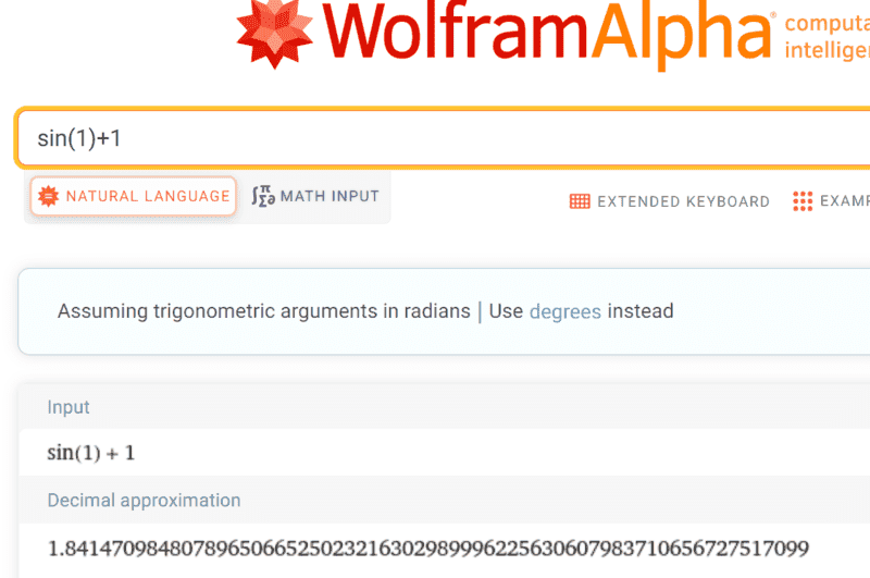

Stephen Tashi said:
I don't know if a similar trick can be done with a compiled language like C++ or Dlang. Once a program begins executing, can a library that it uses be dynamically modified?
If the program makes use of a symbolic math library, yes.
Programs like Mathematica and Wolfram Alpha can be written in C++, or any other compiled language. They handle user supplied strings that represent math functions.
