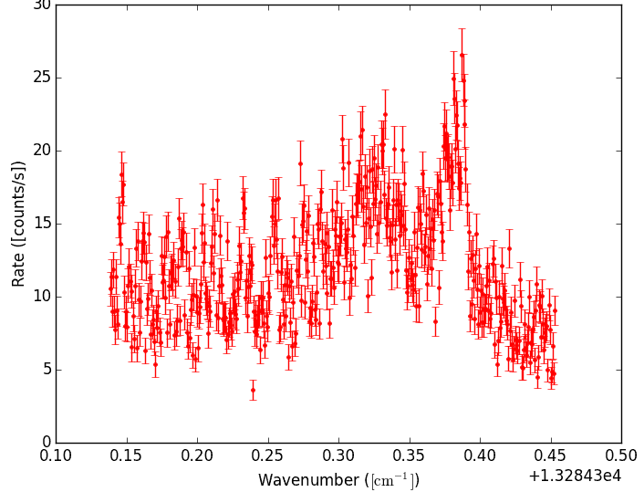

@hutchphd @gleem thank you a lot for your help with this. So the frequency of the laser (the x axis) is supposed to increase in a fixed amount over a certain range. However the frequency of the laser is not very stable, so even if it is overall going up, it has lots of variations over small periods of time. This is the main reason why we do measurements at such small time intervals, to know exactly what frequency we are testing. Of course it the laser was stable for, say 1 second, we could measure the counts every one second, and would get much better statistics from one measurement. But because of this laser instability, this is the data I have. However, you can assume that the values of time, counts and wavenumber are right. The percentage of number of events per measured data is more or less what you got, many measurements give zero counts, but of course we have more than 2000 events per one scan range. I could share one scan file i.e. an actual measurement from beginning to the end of a scan, but the .txt file is too large and the .h5 compression is not allowed here. Let me know if there is a way to share it here (the .txt has 30 MB). I attached below the plot obtained from that scan (which is also the scan I shared the 2000 data points from). The binning is not really right: for each bin I calculated the total number of events and divided by the total measurement time in that bin. This is obviously wrong as the time needs to be normalized, but it is just for visual purposes (after all the main issue here is that I don't know how to bin properly). In this case the bin size is ##0.0006671 cm^{-1}##, which corresponds to 20 MHz (which is more or less the bin size we want). As you can see there is a small peak then a bigger one between 0.3 and 0.4, which is where we expect them to be from theory. Of course, we have multiple scans of this region, so we will combine multiple scans and the peaks will become more clear, but the binning procedure (which I need help for) should be the same no matter how much data I have.
So long story short, I need to make a proper binning of the data I show below (this binning is wrong, but might help you understand the data), then I need to fit this with 2 Voigt profiles (or something more complicated, depending on some theoretical parameters) and my main question is how to do the binning.
Thank you again for help, and please let me know if you need more details.
Data looks good to me. Your choice of fit should probably be driven by the number you are most interested in...e.g. do you want the splitting or the absolute number etc etc). Also the way you fit the data will likely not be very sensitive to your binning choice (within reason). You should check that in the end. Enjoy.
My impression of the spectrum you have shown.
How many measurements were binned?
what are the widths of the peaks in cm-1 than you are looking for?
Very noisy. Error bars may not reflect (underestimate) the random fluctuations in the data unless this is a structured noise. You say you expect to fit two or more peaks. The data is pretty crowded so it is hard to distinguish peak like structures but their may be five of six if you error bar are reasonable (which I am skeptical of).
Calculating a rate from the summed events in the bin divided by the time interval of the bin is IMO acceptable.

@gleem @hutchphd Thank you for you reply! The plot might look good, but the binning is wrong. As I said, for each bin I divided the total number of counts by the total measuring time in that bin. Also the error on each point is square root of the number of points divided by time (time is not under square root). But this is wrong. This works only if for each point the measuring time was the same, but it is not. For example (a bit exaggerated, but illustrates the point), if we have 1000 counts in 10 seconds and 200 counts in 20 seconds, adding the rates I get ##100+10=110##, which is right i.e. if I would count for 1 second I expect 110 counts. But the way I did gives ##(1000+200)/(10+20)=40## which is no where close to the right value. So my approach was just for visual purposes but it is very wrong. I also found this post, somehow related to my question: https://www.physicsforums.com/threads/bin-center-location.978600/ Everyone there seems to agree that this approach of adding the counts and dividing by total time, for each bin, is fundamentally wrong. So my initial question is still open, what is the right way to combine the data and what is the error on each of these new data points?
@gleem For this plot I used 372562 data points. Most of the scans have more data than this. Also, yes, as I said, I am not sure at all about the error on the points, this is also part of my original question. The fitting procedure is a bit more complicated. You are right there are more than 2 peaks, but they should become visible once multiple scans are combined. The fit will be done using a theoretical template, from which we know how many peaks we expect, we also know that some peaks (from rotational excitations, for example) should be equally spaced, which constraints a lot of parameters. But this comes latter, for now I still don't know how to properly bin the data. The width of the peaks I would say are between 0.01 and 0.1 ##cm^{-1}##, depending on the type of transition.
About the laser, the original idea was to to increase the frequency by ##0.06 cm^{-1}## per second. But it turns out that doing this laser frequency changing is not as smooth as we expected, so going from one step to the next is not smooth at all, so we get a lot of jitter. So it's a bit difficult to predict how the laser will change, given that we also force it to change, but we don't have a great control on the actual changing mechanism. So in the end we decided to just measure the frequency very often to know at least what it is going on. We might rerun the experiment later, with a much stable laser, but for now this is the only data available.
Thank you and let me know if I can provide further information.

The width of the peaks I would say are between 0.01 and 0.1 cm−1cm−1cm^{-1}, depending on the type of transition.
This should tell you how many data points to bin. You want enough points in the peak to define it well enough to fit it with reasonable accurate parameters. So if your energy increment is 0.0006 cm-1 and the width of the peak is 0.01 cm-1 at the narrowest then assuming 6 data points (but not less than 4) within the full width at half max is adequate then you will need 6 bins (but not less than 4) to span the peak each with 3 data (not more than 4 data points) points in each bin.
Maybe this is not important but, since your energy increments are not the same and sometime increase and sometimes decrease you should first go through the data and order the energies to be always increasing.
Assign a bin energy equal to the average of the energies within. An of course you need to normalize the time intervals since they vary too much.

Sorry for not coming back to that. I tried it, but it seems like I have some data points (I guess random fluctuations), for which the measurement time is very small (around 0.001 seconds) but I have 1 count in that time. This gives a huge rate, making that bin significantly bigger than the others, even if there is not way for it to be the case, physically. Should I somehow do some time weighting? Thank you!
Thank you for your reply. How should I do time normalization? Assuming I have 1 count in 0.01 seconds and 1 count in 0.02 seconds, should I normalize by taking 2 counts in 0.02 seconds and 1 count in 0.02 seconds, getting an average of 1.5 counts in 0.01 seconds? I am not sure if I can just multiply the counts by 2 (or any integer). That 1 count is the result of a Poisson process so I am not sure that having 1 count in 0.01 seconds implies 2 in 0.02 seconds.
