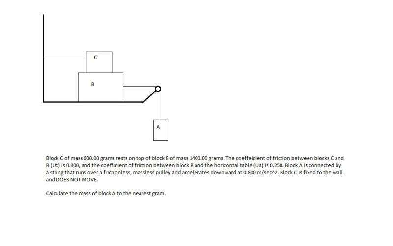

miktalmyers
Calculating mass of a block...
Force equations/Kinetic equations
FA = mA * 9.8 m/sec2
FA = FB
where FB is the force acting through the string from A to B
The forces on B are friction from the table, friction from C, and the force it takes to move B's mass at 0.8 m/sec2
FB = FfB + FfC + (1.4 kg * 0.8 m/sec2)
FfC = 0.3 * ( 0.6 kg * 9.8 m/sec2 )
FfC = 1.764 N
FfB = 0.25 * [ (1.4 kg + 0.6 kg) * 9.8m/sec2 ]
FfB = 4.9 N
FB = 1.764 N + 4.9 N + (1.4 kg * 0.8 m/sec2)
FB = 7.784 N
FA = 7.784 N
7.784 N = mA * 9.8 m/sec2
mA = 0.794286 kg ~ 794 grams
No one?
This is not FA (the string tension), this is the weight of block mA. FA must be less than the weight of block mA, or else it can't accelerate downward.
FA = FB
yes, this is correct.
stay away from pseudo forces, the horizontal forces on B are friction from the table, friction from C, and the tension force FB
yes...
FfC = 1.764 N
FfB = 4.9 N
FB = 7.784 N
FA = 7.784 N
I'm not checking your numbers, but your equations are OK
This is your error as i noted above; the weight mA acts down, and FA acts up, solve for mA using Newton 2.
