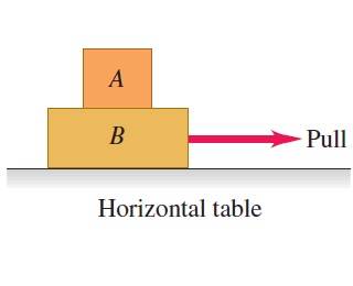

Block A rests on top of block B as shown in (Figure 1). The table is frictionless but there is friction (a horizontal force) between blocks A and B. Block B has mass 6.00 kg and block A has mass 2.00 kg. If the horizontal pull applied to block B equals 12.0 N, then block B has an acceleration of 1.80 m/s2. What is the acceleration of block A
So my understanding is that from F = ma we can determine for block B that F = (6 kg)(1.80 ms2) = 10.80 N we can then say that block A is experiencing the same force yielding F - F(friction) = m a or 10.8 N - (2.0kg)(g)u = (2kg)(a). However i do not know how to solve for acceleration of A without the coefficient of friction

It would help if you posted the figure that goes with this problem. Use the link button "Attach files" on the lower left.
attached in edit
Thanks. Now consider this. How many forces act on the top block and what object(s) exert(s) them on it?
there is the gravitational force, the applied force, and the frictional force the applied force is applied by the bottom block

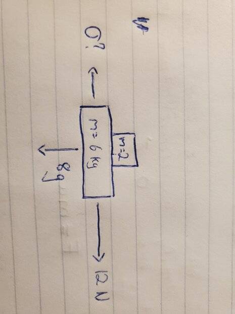

what would the equation be for that the 0 friction is throwing me off. would it just be 6 m/s2 from 12N = 2kg a??
Cutter Ketch said:
Draw the free body diagram for B. The method for solving the problem should then be apparent.
Well, sort of. A) What is that force to the left? Where does it come from. B) it’s not F=ma as you indicated for relevant equations, it’s
##\sum F## = ma so what should you do with that free body diagram?
Outline:
1) Draw a FBD for block A
2) Write Newtons Second Law for block A
3) Draw FBD for Block B
4) Write Newtons Second Law for block B
5) Combine the two equations, solve for the acceleration of block ##A##
Where you might get stuck...the frictional force acting between blocks A and B. If it necessarily acts on block ##A## in a certain direction, in which way does it act on block ##B##?
Can you visualize block A accelerating at a lower rate than block B and falling behind?
If no friction existed between A and B, block A would not move respect to the ground, and our force of 12.0 N would induce a greater acceleration than 1.8 m/s2 to block B 9only one experiencing that force then).
If blocks A and B were solidly linked together, both blocks would move respect to the ground with identical acceleration, and our force of 12.0 N would induce a lower acceleration than 1.8 m/s2 to the A-B block system of mass 8.0 kg.
