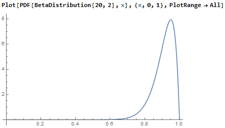

This is a textbook application for Bayesian inference. If you have a binomial trial with n successes and m failures then the posterior probability is beta distributed with shape parameters n+1 and m+1. So if you have 19 successes and 1 failure then the probability of success is shown below. The 95% credible region is [0.762,0.988].
