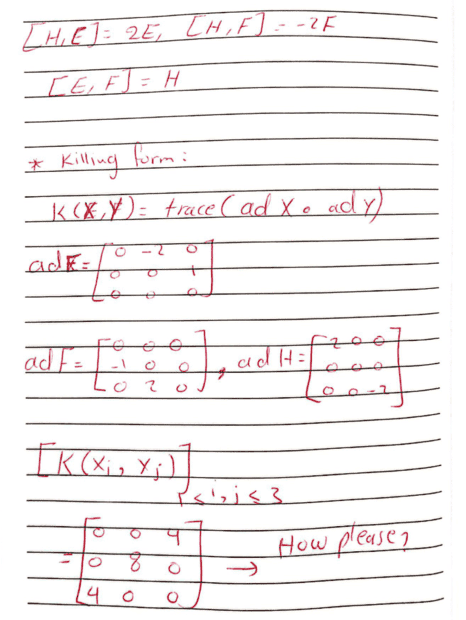

Homework Statement: please, could you help me to know hoe I compute the Casimir element of lie algebra sl(2), I know the basis and their relations, but i could not find the book explain in details how we get the Casimir element.. I think it is related to killing form, but also I could not find the final matrix( as you see in attachment).
I would appreciate if you could help
thank in advance,
Relevant Equations: Casimir element is : C= 4FE+H(H+2)
I have attached the file

Why don't you calculate the Killing form?
\begin{align*}
\operatorname{ad}(X)&=x_1\operatorname{ad}(E)+x_2\operatorname{ad}(H)+x_3\operatorname{ad}(F)=
\begin{pmatrix}2x_2&-2x_1&0\\-x_3&0&x_1\\0&2x_3&-2x_2\end{pmatrix}\\[6pt]
\operatorname{ad}(X)\operatorname{ad}(Y)&=\begin{pmatrix}4x_2y_2+2x_1y_3&4x_2y_1&-2x_1y_1 \\ 2x_3y_2&2x_1y_3+2x_3y_1&2x_1y_2\\ -2x_3y_3&4x_2y_3&4x_2y_2+2x_3y_1\end{pmatrix} \\[8pt]
K(X,Y)&=4x_2y_2+2x_1y_3+2x_1y_3+2x_3y_1+4x_2y_2+2x_3y_1\\[6pt]
&=4x_1y_3+8x_2y_2+4x_3y_1
\end{align*}
If we set ##X^{(1)}=E=(1,0,0)\, , \,X^{(2)}=H=(0,1,0)\, , \,X^{(3)}=F=(0,0,1)## then we need to find ##Y^{(1)}\, , \,Y^{(2)}\, , \,Y^{(3)}## such that ##K\left(X^{(i)},Y^{(j)}\right)=\delta_{ij}.## Each ##Y^{(j)}## has coordinates ##Y^{(j)}=(y_1^{(j)},y_2^{(j)},y_3^{(j)})=y_1^{(j)}\cdot E +y_2^{(j)}\cdot H+y_3^{(j)}\cdot F.##
These are ##9## unknowns and ##9## linear equations. Solve it. Then we get
c_{\operatorname{ad}}(K)=\operatorname{ad}(E)\circ \operatorname{ad}(Y^{(1)})+\operatorname{ad}(H)\circ \operatorname{ad}(Y^{(2)})+\operatorname{ad}(F)\circ \operatorname{ad}(Y^{(3)})
with the trace ##\operatorname{trace}(c_{\operatorname{ad}}(K))=K(E,Y^{(1)})+K(H,Y^{(2)})+K(F,Y^{(3)})=3## ...
... if neither you nor I made any mistakes with the signs and indices.

Dear Fresh_42, thank you so much from the bottom of my heart for your help,
please, please, I have a question, here:
If we set $X^{(1)}=E=(1,0,0), X^{(2)}=H=(0,1,0), X^{(3)}=F=(0,0,1)$ then we need to find $Y^{(1)}, Y^{(2)}, Y^{(3)}$ such that $K\left(X^{(i)}, Y^{(j)}\right)=\delta_{i j}$. Each $Y^{(j)}$ has coordinates
Y^{(j)}=\left(y_1^{(j)}, y_2^{(j)}, y_3^{(j)}\right)=y_1^{(j)} \cdot E+y_2^{(j)} \cdot H+y_3^{(j)} \cdot F
how we can solve this, just give the first step, i could not get it,
i need to get this matrix, please bear with me,

The basis ##(E,H,F)## of ##\mathfrak{sl}(2)## is nice, but if we have to solve nine equations in nine variables it will get a mess with only letters. Therefore we need indices. Say ##X_1=E\, , \,X_2=H\, , \,X_3=F.##
If general vectors are ##X=x_1X_1+x_2X_2+x_3X_3## and ##Y=y_1X_1+y_2X_2+y_3X_3## then we have ##K(X,Y)=4x_1y_3+8x_2y_2+4x_3y_1.##
We have the adjoint representation in this case. We need to find the dual basis for the Casimir element. The Killing-form of the special linear algebra is non-degenerate so a dual basis exists, say it is
\left(Y_1,Y_2,Y_3 \right)=(y_{11}X_1+y_{12}X_2+y_{13}X_3,y_{21}X_1+y_{22}X_2+y_{23}X_3,y_{31}X_1+y_{32}X_2+y_{33}X_3)
expressed in the basis ##(E,H,F).## Then we have to solve
\begin{align*}
1&=K(X_1,Y_1)=K(X_1,y_{11}X_1+y_{12}X_2+y_{13}X_3)=4y_{13}\text{ as } x_1=1,x_2=0,x_3=0\\
0&=K(X_1,Y_2)=K(X_1,y_{21}X_1+y_{22}X_2+y_{23}X_3)=4y_{23}\text{ as } x_1=1,x_2=0,x_3=0\\
0&=K(X_1,Y_3)=K(X_1,y_{31}X_1+y_{32}X_2+y_{33}X_3)=4y_{33}\text{ as } x_1=1,x_2=0,x_3=0\\[6pt]
0&=K(X_2,Y_1)=K(X_2,y_{11}X_1+y_{12}X_2+y_{13}X_3)=8y_{12}\text{ as } x_1=0,x_2=1,x_3=0\\
1&=K(X_2,Y_2)=K(X_2,y_{21}X_1+y_{22}X_2+y_{23}X_3)=8y_{22}\text{ as } x_1=0,x_2=1,x_3=0\\
\ldots&
\end{align*}
This gives us the dual basis ##(Y_1,Y_2,Y_3)## expressed in the basis ##(X_1,X_2,X_3)=(E,H,F).## Seems the result will be
\begin{pmatrix}1/4&0&0\\ 0&1/8&0\\ 0&0&1/4 \end{pmatrix}
That would make sense since
K(X_1,Y_1)+K(X_2,Y_2)+K(X_3,Y_3)=4\cdot 1 \cdot \dfrac{1}{4}+8\cdot 1\cdot \dfrac{1}{8}+4\cdot 1\cdot \dfrac{1}{4}=3

It is
\begin{align*}
K(X_1,Y)&=K(1\cdot X_1+0\cdot X_2+0\cdot X_3\, , \,y_{11} X_1+y_{12} X_2+y_{13} X_3)\\
&=K\left(\begin{pmatrix}x_1\\x_2\\x_3 \end{pmatrix}\, , \,\begin{pmatrix}y_{11},y_{12},y_{13}\end{pmatrix}\right)\\
&=4 \cdot x_1\cdot y_{13}+8\cdot x_2\cdot y_{12}+4\cdot x_3\cdot y_{11}\\
&=4\cdot 1\cdot y_{13}+ 8\cdot 0\cdot y_{12}+4\cdot 0 y_{11}\\
&=4y_{13}
\end{align*}
Therefore ##1=K(X_1,Y)=4y_{13}## since ##X_1=(1,0,0).##

I computed this from your matrices for ##\operatorname{ad}E, \operatorname{ad}H, \operatorname{ad}F.##
An arbitrary vector looks like ##X=x_1E+x_2H+x_3F## and ##Y## accordingly. ##\operatorname{ad}## is linear, so ##\operatorname{ad}X=x_1\operatorname{ad}E+x_2\operatorname{ad}H+x_3\operatorname{ad}F ## and the same with ##\operatorname{ad}Y.##
You already had calculated all matrices ##\operatorname{ad}E, \operatorname{ad}H, \operatorname{ad}F## so I had only to construct ##\operatorname{ad}X## and ##\operatorname{ad}Y.## Then I multiplied them with https://www.symbolab.com/solver/matrix-calculator (sorry for laziness) and since
K(X,Y)=\operatorname{trace}(\operatorname{ad}X \cdot \operatorname{ad}Y)
I finally added all entries on the main diagonal which was ##K(X,Y)=4x_1y_3+8x_2y_2+4x_3y_1\quad (*).##
(You had the same result but on the wrong diagonal. You probably switched indices somewhere.)

I did this with the formula above. But we have to find (setting ##X_1=E, X_2=H,X_3=F##) three vectors ##Y_1,Y_2,Y_3## such that ##K(X_i,Y_j)=\delta_{ij}\quad (**).##
So I wrote ##Y_j=y_{j1}X_1+y_{j2}X_2+y_{j3}X_3## for ##j=1,2,3.## The ##X_i## are ##X_1=1\cdot X_1+0\cdot X_2+0\cdot X_3## and so on. Now I fed the formula ##(*)## with these coordinates and solved ##(**).##
HDB1 said:
finally, the killng form will be this? please:
K(x, y)=\left(\begin{array}{lll}
y_{11} & y_{12} & y_{13} \\
y_{21} & y_{22} & y_{23} \\
y_{31} & y_{32} & y_{33}
\end{array}\right)
$$thanks a lot,
No. The Killing form is a number, a trace, the sum of diagonal entries of a matrix which is a product of two matrices. In our example we have ...
##\operatorname{ad}## is a linear function from the three-dimensional vector space ##\mathfrak{sl}(2)=\operatorname{lin\,span}\{X_1=E,X_2=H,X_3=F\}## into the nine-dimensional vector spcace of ##3\times 3## matrices ##\mathfrak{gl}(\mathfrak{sl}(2)).##
That ##E,H,F## are themselves two-dimensional matrices is no longer of interest. ##\operatorname{ad}E,\operatorname{ad}H,\operatorname{ad}F## are three-dimensional matrices with ##9=3^2## entries. Say ##\operatorname{ad}(X)=(x_{ij})## and ##\operatorname{ad}Y=(y_{kl})## where all indices run from ##1## to ##3##, then
\begin{align*}
\operatorname{ad}(X) \cdot \operatorname{ad}(Y)&=\left(\sum_{j=1}^3 x_{pj}y_{jq}\right)_{pq}\\[6pt]
\operatorname{trace}\left(\operatorname{ad}(X) \cdot \operatorname{ad}(Y)\right)&=
K(X,Y)=\sum_{k=1}^3 \left(\sum_{j=1}^3 x_{kj}y_{jk}\right)_{kk}
\end{align*}
This is how I calculated the Killing form above, starting with the matrices for ##\operatorname{ad}E,\operatorname{ad}H,\operatorname{ad}F,## then using the matrix calculator for the multiplication ##\operatorname{ad}X\cdot \operatorname{ad}Y## and finally adding all the entries on the main diagonal.
So all in all we have:
\begin{align*}
\mathfrak{sl}(2) &\stackrel{\operatorname{ad}}{\longrightarrow } \mathfrak{gl}(3)\\[6pt]
X &\longmapsto (Y \longmapsto \operatorname{ad}X(Y)= [X,Y])
\end{align*}
___________________
Just a last remark that might confuse you, so don't panic. The adjoint representation is a Lie algebra homomorphism. So its kernel is an ideal in ##\mathfrak{sl}(2).## But ##\mathfrak{sl}(2)## is simple and has no ideals. Hence the kernel is either ##\{0\}## or the entire Lie algebra ##\mathfrak{sl}(2).## The latter would imply that ##\operatorname{ad}=0## which it is not. Thus the kernel is zero and ##\operatorname{ad}## injective. Hence the image ##\operatorname{ad}(\mathfrak{sl}(2)) ## is a three-dimensional simple Lie algebra in the nine-dimensional Lie algebra ##\mathfrak{gl}(\mathfrak{sl}(2))=\mathfrak{gl}(3)## that is isomorphic to
\begin{align*}
\mathfrak{sl}(2) &\cong \operatorname{lin\,span}
\left\{ \operatorname{ad}E,\operatorname{ad}H,\operatorname{ad}F\right\} \subseteq \mathfrak{gl}(3)
\end{align*}

Dear @fresh_42, thank you so much from the bottom of my heart for your clarification,
Please, the last question ( i get the answer but i would like to know in general) how we get this matrix, i mean what is its entries? ( I know the relation of E, H and F, but how we put the numbers inside the matrix)
\operatorname{ad} E=\left(\begin{array}{ccc}
0 & -2 & 0 \\
0 & 0 & 1 \\
0 & 0 & 0
\end{array}\right)
thanks in advance,
To write a matrix we need
a) a linear function
b) the vector spaces this function maps from one to the other
c) bases for these vector spaces, which must not only span the vector spaces and be linearly independent but are also ordered, i.e. the basis vectors must be enumerated.
We have a) ##\operatorname{ad}E## and b) ##\operatorname{ad}E\, : \,\mathfrak{sl}(2)\rightarrow \mathfrak{sl}(2),## i.e. the vector spaces are ##\mathfrak{sl}(2)## in both cases. We also have a basis of ##\mathfrak{sl}(2),## namely ##H,F,E.##
So all that's left to know is an order. Normally, we would start with an order, say ##v_1,v_2,v_3## and write the matrix of ##\operatorname{ad}E## as ##(\operatorname{ad}E(v_1),\operatorname{ad}E(v_2),\operatorname{ad}E(v_3))## expressed as column vectors according to the basis ##(v_1,v_2,v_3).##
But in this case, you already have written the matrix. Let's see what this means for our basis.
The first column vector of ##\operatorname{ad}E## is the zero vector. So we can choose ##v_1=E## since ##\operatorname{ad}E(E)=[E,E]=0.## For the second column ##\operatorname{ad}E(v_2)## we have ##\operatorname{ad}(E)(v_2)=-2v_1.## Hence, ##v_2=H## does the job since ##\operatorname{ad}E(H)=[E,H]=-[H,E]=-2E=-2v_1.## The same with the third column and ##v_3=F.## Here we have ##\operatorname{ad}E(v_3)=v_2## and we can choose ##v_3=F## since ##\operatorname{ad}E(F)=[E,F]=H=v_2.## So our ordered basis is ##(v_1,v_2,v_3)=(E,H,F)## according to which we have written the matrix of ##\operatorname{ad}E.##
Please note, that ##\operatorname{ad}## itself is also a linear transformation. It maps the vector space ##\operatorname{ad}(\mathfrak{sl}(2))## into the general linear Lie algebra ##\mathfrak{gl}(\mathfrak{sl}(2))=\mathfrak{gl}(3).## This is a map from a three-dimensional vector space into a nine-dimensional vector space. It maps the basis ##(\operatorname{ad}E,\operatorname{ad}H,\operatorname{ad}F)## onto the ##3\times 3## matrices you found in post #1. They do not span ##\mathfrak{gl}(3).## They span only a three-dimensional subspace and we have
\mathfrak{sl}(2) =\operatorname{lin \,span} \{E,H,F\} \cong \mathfrak{ad}(\mathfrak{sl}(2))=\operatorname{lin \,span} \{\operatorname{ad}E,\operatorname{ad}H,\operatorname{ad}F\} \subseteq \mathfrak{gl}(3)

Please correct me if I'm wrong. I assume you refer to post #9. Since we deal with ##3\times 3## matrices, i.e. nine entries, it is better to have a numbered basis, so I set ##X_1=E\, , \,X_2=H\, , \,X_3=F.##
Say we have two arbitrary vectors ##X=x_1X_1+x_2X_2+x_3X_3=x_1E+x_2H+x_3F## and ##Y=y_1X_1+y_2X_2+y_3X_3=y_1E+y_2H+y_3F## then
K(X,Y)=\operatorname{trace}(\operatorname{ad}X \operatorname{ad}Y)=4x_1y_3+8x_2y_2+4x_3y_1\;(*)
This is the general formula obtained by taking the matrices of ##\operatorname{ad}X## and ##\operatorname{ad}Y,## multiplied them, and finally taking the trace.
We need the dual basis of ##\{X_1,X_2,X_3\}## in order to calculate the Casimir element and in particular its trace. Let ##\{Y_1,Y_2,Y_3\}## be that basis. Duality means that ##K(X_i,Y_j)=\delta_{ij}\; (**).##
Hence I wrote the vectors ##Y_j## in the basis ##\{X_1,X_2,X_3\},## i.e. ##Y_j=y_{j1}X_1+y_{j2}X_2+y_{j2}X_3## and solved this linear equation system ##(**)## for the variables ##y_{ij}.## The result was that ##Y_1=(1/4)X_1\, , \,Y_2=(1/8)X_2\, , \,Y_3=(1/4)X_3.##
Finally, I go back to ##(*)## in order to compute ##K(X_i,Y_i).## The formula holds true for any vectors ##X,Y## expressed in the basis ##\{X_1,X_2,X_3\}.## But here we have
\begin{align*}
X_1=x_1X_1+x_2X_2+x_3X_3=1\cdot X_1 +0\cdot X_2+0\cdot X_3& \triangleq (x_1,x_2,x_3)=(1,0,0)\\
X_2=x_1X_1+x_2X_2+x_3X_3=0\cdot X_1 +1\cdot X_2+0\cdot X_3&\triangleq (x_1,x_2,x_3)=(0,1,0)\\
X_3=x_1X_1+x_2X_2+x_3X_3=0\cdot X_1 +0\cdot X_2+1-\cdot X_3&\triangleq (x_1,x_2,x_3)=(0,0,1)\\
Y_1=y_{11}X_1+y_{12}X_2+y_{13}X_3=(1/4)\cdot X_1+0\cdot X_2+0\cdot X_3&\triangleq (y_1,y_2,y_3)=(1/4,0,0)\\
Y_2=y_{21}X_1+y_{22}X_2+y_{23}X_3=0\cdot X_1+(1/8)\cdot X_2+0\cdot X_3&\triangleq (y_1,y_2,y_3)=(0,1/8,0)\\
Y_3=y_{31}X_1+y_{32}X_2+y_{33}X_3=0\cdot X_1+0\cdot X_2+(1/4)\cdot X_3&\triangleq (y_1,y_2,y_3)=(0,0,1/4)
\end{align*}
So our formula ##(*)\; K(X,Y)=4x_1y_3+8x_2y_2+4x_3y_1## becomes
K(X_1,Y_1)=4\cdot 1\cdot (1/4)\, , \,K(X_2,Y_2)=8\cdot 1\cdot (1/8)\, , \,K(X_3,Y_3)=4\cdot 1\cdot (1/4)
and the sum equals ##3,## the dimension of ##\mathfrak{sl}(2).##
