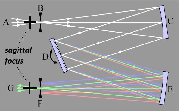

Basically, in a Czerny-Turner like (classical picture from here but most likely stolen from here):
the optics create an image of the entrance slit (B) on the exit slit (F). The image is dispersed: images for different wavelengths end up at different positions and a spectrum is obtained by (very slowly) rotating grating D and measuring the light intensity after the exit slit versus the angle.
Entrance slit B is at the focus of mirror C that creates a parallel beam at grating D. So your instrument has an F/D of about 1/11 (55/600). If the incoming beam (AB) has a larger angle, intensity is lost. If the angle is smaller, less of the grating is used resulting in lower resolution of the spectrometer.
In a CCD Spectrometer, the exit slit is replaced by a CCD (see one here). So I am surprised by your

Aren't mirrors C and E cylindrical in your monochromator ? What would cause focusing in the vertical direction ?
5. I don't believe so. In the documentation (the predecessor of the HR640 monochromator and built many decades ago) the monochromator uses spherical mirrors, so I should get both sagittal and tangential focus.

Yes, I was completely mistaken o:) . The imaging of the entrance slit on the exit slit is both vertically and horizontally in order to get maximum light out.

The Czerny-Turner monochromator uses spherical mirrors (not cylindrical as assumed) to transmit the image of the entrance slit to the exit slit through a dispersive element (diffraction grating). The slit image exhibits astigmatism and coma aberrations.
Coma is compensated at one wavelength in the middle of the working range by balancing the coma of the collimator mirror with the coma of the opposite sign of the focusing mirror through the angular magnification of the diffraction grating.
Astigmatism is not corrected because it does not affect the projection of the elongated input slit to the output slit. Astigmatism means there are two different focuses in the meridional and sagittal planes. The monochromator achieves a sharp focus across the slit to create sharp edges. The second focus along the slit is located a few millimeters outside the slit. However, focusing your image outside before the entrance slit significantly truncates the angular acceptance aperture of the monochromator.
