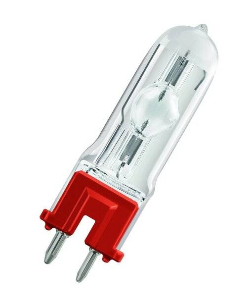

The old light source is an arc light so it mostly has a size of roughly the distance between the electrodes, on the order of 6-10mm by my eye.
Photo of a double-ended halogen-style lamp with a clear glass envelope, a small internal bulb, and a red plastic base with two metal pins.

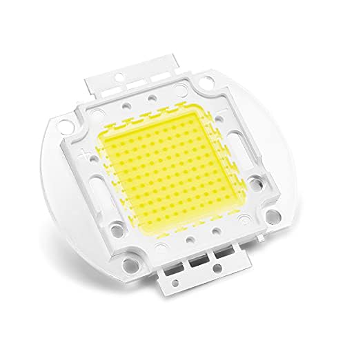

The new light source is an array of LEDs perhaps 25mm square. some are round. It is already reasonably diffuse. White-emitting versions and certain colours are phosphor converted. The light is not entirely uniform (it hot-spots where the emitters are) but it is essentially a diffuse source. We might also use red, green and blue emitters and seek to combine them, for colour mixing.
Photo of a high-power white LED module on a white heat-sink base with mounting tabs and screw holes, showing a square array of yellowish-white emitting dies.
I guess my interest at this point is whether we can do something like the following, just with LEDs. This seems to imply that the many parallel beams can be reduced into a fiber using practically-achievable optical parts (it shows green and blue being combined, but each colour is combined from many diodes).

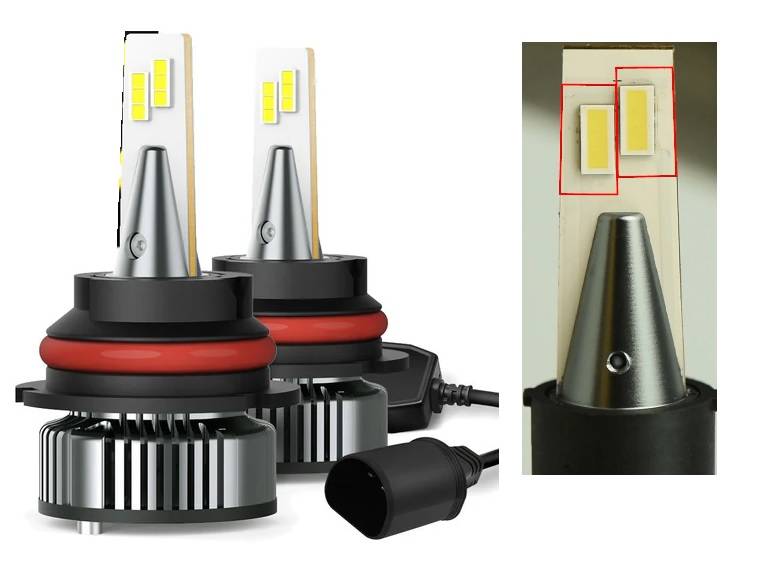

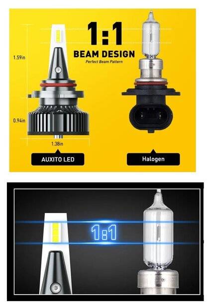

There are LEDs lamp intended for halogen lamp replacement for the cars headlight, they are suit the best for replacement of your arc lamp. I would suggest that you may try something like this LED headlight bulbs https://www.auxito.com/products/9005-led-headlight-bulb-80w-16000-lumen:
Side-by-side comparison on yellow: AUXITO LED headlight bulb with dimensions 1.59in height, 0.94in base height, 1.38in width, and a halogen bulb labelled Halogen; text reads 1:1 Beam Design, Perfect Beam Pattern. Lower panel shows both bulbs against black with a blue 1:1 label.
LEDs are mounted on both sides and can provide about 8000 lm flux from every side, 16000 lm total, but it can be the problem that light from the back side would be blocked by the lamp itself.
Or, may be this is better, with double LED modules mounted very close on the one side, providing 16000 lm:
Two car headlight LED bulbs with H13-style bases, each with a metal cooling fin heatsink, a black cap and white LED chip boards on a vertical stem. Inset close-up of one stem with two LED chips outlined in red boxes.
Using those type of LED modules hopefully the condenser system would fit the image of the LED to the exit pupil of the projection lens, utilising not all, but significant part of the LED output.
