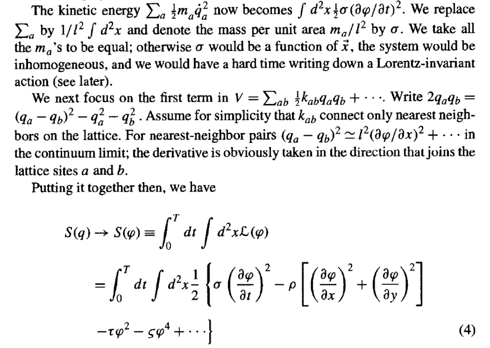

I am not sure where does the dy term, phi^2 and phi^4 terms come from.
I guess there are dx and dy because we have to account for the nearest neighbour pairs in the x and y axis?
I guess there is a phi^2 term because 2q_a*q_b=(q_a-q_b)^2-q_a^2-q_b^2, the term q_a^2-q_b^2?
How about the phi^4 term?
That is correct.
In his expression for ##V##, he is only writing the first term in a power series, and the power series will really include all higher powers too. Although he is presumably assuming that the potential is symmetric under taking all the ##q_a## to ##-q_a##, otherwise there would be a ##\phi^3## term too. (Actually, looking at my copy of Zee, it seems that the very next equation in the book does include ##\phi^3## so this might just be a typo.) So the next term will look like
V = \sum_{ab} \frac{1}{2} k_{ab} q_a q_b + \sum_{abcd} k_{abcd} q_a q_b q_c q_d + \cdots
Now when you take the continuum limit of this, you'll get a bunch of terms including a ##\phi^4## term (and also terms like ##(\partial_x \phi)^2 \phi^2## which are presumably included in the ellipses along with higher order terms). If I had included a cubic term it would also allow terms like ##\phi^3##.
