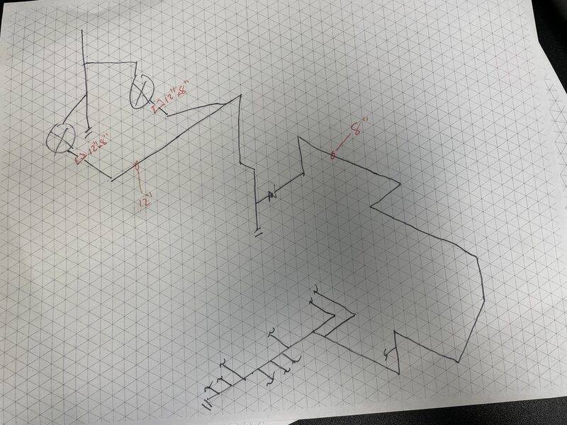

Haotranphotomask said:
We have a tool that requires 1300 CFM of exhaust that was previously tied to another exhaust system. They were running into problem with that system, so they decided to move that tool's exhaust trunk to the fans (the fans in this thread, one of them is a spare) that are abandoned in place. The system that was previously tied to these fans are no longer in operation and the tie-in trunk was capped for the tie in of the new tool.
The tool itself has about 11 exhaust lines, all tied into an 8" trunk. This trunk has about 200 ft of piping and 12 elbows. Then it's expanded to a 12" trunk (about 20 ft with 4 elbows). Then it's reduced to the inlet of the fans.
The discharge side is pretty much just a straight 15ft 12" line.
Consider that the poor fan is working in a sucking-from-many-points situation, rather than pushing air, which is its best performance configuration and design assumption.
It can only create certain lower-than-atmospheric pressure in its inlet; the rest of the moving-air-work is done by the atmosphere pushing air through many inlets, duct branches and changes of direction and toward that unique low pressure zone.
Multi-brach exhaust duct systems need to be tested and balanced, as well as carefully sealed from undesired leaks.
Otherwise, your piece of equipment could be “feeling” only a fraction of the exhaust efforts of your motor and fan.
With enough upstream restriction, the fan could be operating to a minimum flow (like having a close upstream damper), way off the desired operational point.

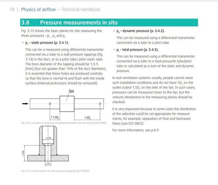

Are you sure you are measuring the static pressure correctly? Where have you taken the measurements. A quick diagram of the fan and surrounding ductwork would be helpful.

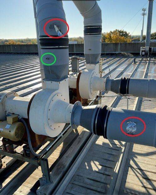

  • #46
I am measuring the SP at the red circles. The green circle is a backdraft damper. I don't think the pressure drop through that damper is significant.
There is about 20ft of 12" piping on the inlet. But the remaining 8" piping totals up to 200 ft. The inlet ports consist of 1 ft of 3"-5" pipes.
  • #47
View attachment 318429View attachment 318428
I'm confused. The inlet has 200 ft of piping. The discharge appears to have 20 ft of 12" piping?
  • #48
Sorry for the confusion. The inlet consists of 200 ft of 8" piping, then expanding tee to 20 ft of 12" piping, and then reduce to 8" to tie into the inlet of the fans. The discharge is another 20 ft of 12" piping.

What is the measured SP at the inlet port relative to atmosphere?

About -5.5" WC at the inlet and 0.5" WC at the discharge.

  • #59
erobz said:
They are measuring at the red circles. The green circles are a mechanical damper on the discharge.
Thank you very much for the correction.
That makes the situation even worse!
The air turbulence inside any duct (not a pipe in this case) is greatly increased by any backdraft damper.
The damper of the fan in stand-by automatically closes itself under the discharge pressure of the working fan.
  • #60
Yeah, I suspect we could add another 0.5"WC from the open damper. Maybe bringing the total to 7" WC. There would still be a discrepancy. However, if something turns out to be fishy with the measured motor rpm as @jrmichler expects, then everything seems to fall into place - and the fan is operating as expected...which would be good because we could then end the free of charge remote trouble shooting!
