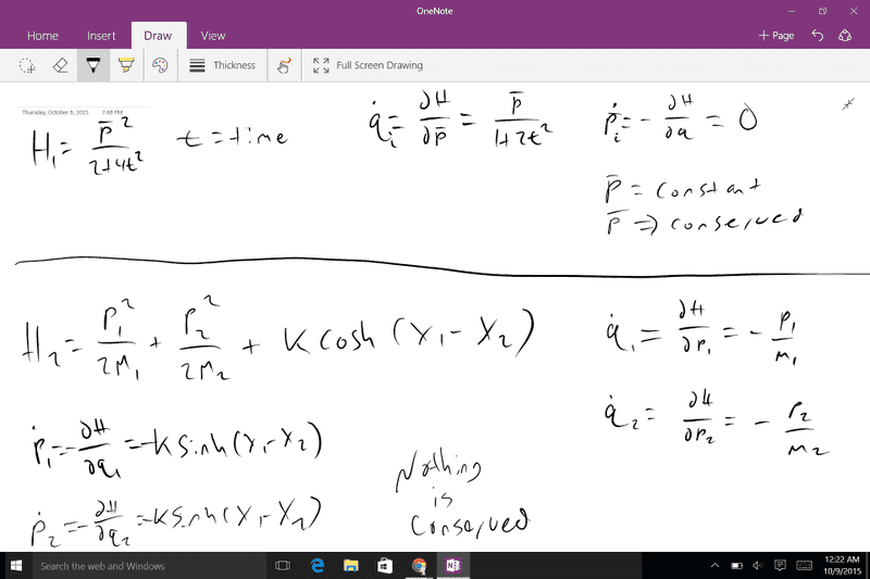

Given the Hamiltonian's determine what quantities are conserved. These are labeled H1 and H2 in the picture.
The relevant equations are q'=dH/dp and p'=-dH/dq
My attempt is below
Handwritten OneNote derivation of conserved quantities: H1 = P^2/(2 m t^2) with t = time, q-dot = dH/dP = P/(m t^2), p-dot = -dH/dq = 0, so P is conserved; H2 = p1^2/2m1 + p2^2/2m2 + K cosh(x1 - x2), with q1-dot = -p1/m1, q2-dot = -p2/m2, p1-dot = -K sinh(x1 - x2), p2-dot = -K sinh(x1 - x2), labeled Nothing is conserved.
ignore the negative sign for q' in H2
Well, looks fine. But, in second problem, one of the [itex]\dot{P}_i[/itex] should be positive and so the total momentum variation will be zero.
