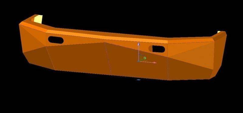

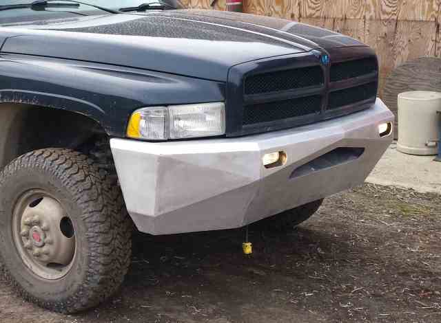

This is the bumper for my truck, It took me months to get the design just right, and then I got the 3/16th aluminum plate CNC plasma cut and welded it all together
The finished product.. with a day of welding and a day of grinding
There's no way I could have made it fit and finish as nicely doing it by hand

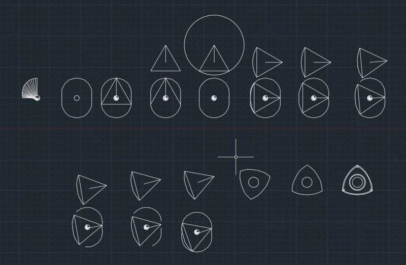

OK, this prompted me to try it out in CAD... I used 15 degree eccentric shaft increments, the eccentric shaft is off-center by 1 unit, the distance from the center of the eccentric base circle to the tip of the rotor is 7 units
As suggested, I drew and rotated lines and then connected them together, mirroring twice to get the full housing... that was the easy part.
Secondly, I drew the line from the uppermost centerpoint of the shaft to the top of the housing, rotated that line ±60 degrees and extended it, then drew a connecting line between where each one crossed the housing, this gives me the 3 tips of the rotor, and the center point.
Next I drew an arc with the centerpoint at a tip of the rotor and a radius equal to the length of the side of the rotor and placed it in the housing.
Incrementally, I rotated the rotor along the same path I used to generate the housing (5/15 degree increments), and whenever any part of the rotor extended past the housing, I'd trim that section off and replace it with the intruding part of the housing..
rinse, repeat, repeat, repeat!
Throw away one half of the remaining arc, mirror it along the centerline of that face, rotate ± 120 degrees to finish the 3 faces...
I couldn't stop there, so I drew in some apex seal grooves, corner seals, side seals and oil control rings.. The rotor bearing has a minimum unit size of 2.
Here's a screenshot.. I worked my way from top left to bottom right.. should give you an idea.. I didn't play with smoothing the lines

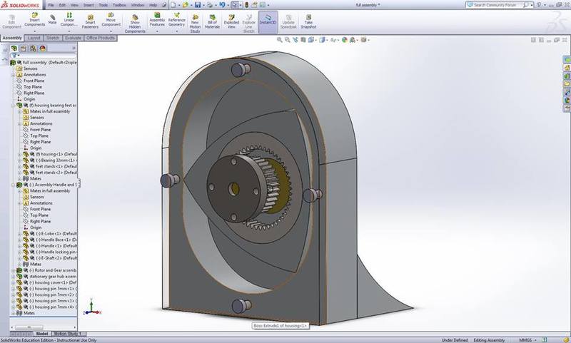

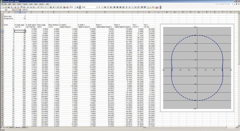

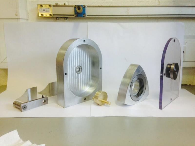

your in luck, i built a model rotary engine as part of my second year project in my Mechanical Eng degree.
it is a difficult shape to machine but i have the two driving formulas which locate the tip of the rotor at any point in the cycle.
here is my solidworks model
i drew my rotor pocket on excel with the equations

here is a quick video of my model in action

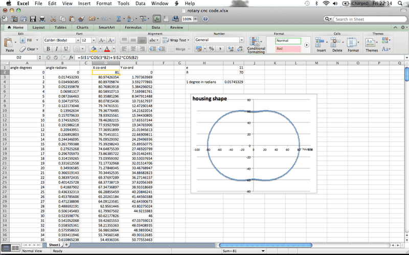

I just drew up an excel spreadsheet with the formula for finding the tip at any point in the rotation... Once I thought about it, it was really easy actually.
Here's a screenshot with the formulas for each column at the top
First you define the angle increments for the E shaft and rotor in degrees and radians, Then calculate the center point of the eccentric shaft X and Y coordinates, then the relative location of the tip of the rotor to the rotor center, sum them to get the relative location of the tip to the E shaft, and graph them. If you look at the images I posted earlier of my CAD drawing it may be more apparent how it works. You can also play with the rotor ratio and see how it affects the shape of the epitrochoid.
I haven't figured out a way to mathematically draw the rotor
The formulas for the X and Y co-ord in my model were taken from the Yamamoto book.
Yamamoto, K 1971. Rotary Engine, Toyo Kogyo Co ltd, Tokyo.
X = e.Cos(3(O))+RCos(O)
Y = e.Sin(3(O))+RCos(O)
where
e = eccentricity
R = Rotor radius
O = Angle in radians
the angle is progressed from 0-360 at 0.5 degrees increments which is then converted to radians to be input in the formula above given 720 X and 720 Y points
The rotor in my owl model was somewhat fudged in solidworks to be as small a radius as possible without fouling against the housing, this was not a critical dimension for me as it was just a model for the demonstration of the principle.
here is my full report documenting the full build of the model, for design calculations see page 24 and onwards.
https://www.dropbox.com/s/dld9nqlf044ml7y/Wankel Rotary Design Report 2014 PDF.pdf?dl=0
Those formulas are pretty much identical to what I drew up, I just separated the steps a little bit and used a ratio for the rotor size instead of a direct value.

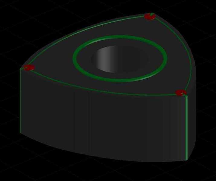

CAD:
Here I have done a details into the coolet jackets, (fig.1, fig.2).
Then I did a much more detailed design for the rotor using three-point-arch instead of a radius one for the edges. I did this because after testing out the rotor shape on the housing the arch does not actually touch the sides all the time so I used three-point-arch. Any suggestions on how to do this with an elliptical arch for I have found it is different to how the person in the video did it on Inventor. Besides the edges of the rotor I have also done more detail with the apexes adding round slots, (by the way what are they for?). I also added arch seal slots and spaces on the side to allow movement. A big change is the combustion cavities or divots on each side. This was done by extruding a block of the base shape out from the rotor and subtracting it, (fig.3)

I think the "rounded slots" are for the "corner seals", and the arched slot is for "side seals".. Usually there is a pair (one may suffice at least for demonstration purposes) of oil control rings.. you have to keep the oil and combustion separate, the steel seals (Side and corner seals) prevent pressurized gasses from getting into the oil, the apex seals prevent gasses from mixing on different sides of the rotor, and the oil seals prevent oil from getting into the combustion chamber. All the seals have a 'kinked metal' kind of spring behind them to keep them pushed against the housing. Go to www.mazdatrix.com.. I think they have all the parts, with pictures.
The arch of the rotor doesn't really need to be super close the the 'peak' of the epitrochoid.. the critical thing is it can never touch.
