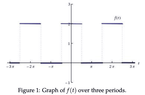

A function ##f## was defined as
$$f(t)=\begin{cases} 2\ \ \ \ \ 0<t<\pi/2 \\ 0\ \ \ \ \ \frac{\pi}{2}<t<\pi\end{cases}$$
and now I see that they explicitly said it has period ##2\pi##. I had understood that they were giving me one period's worth of function.
So the function looks like this according to the solutions
Graph of a periodic step function f(t) over three periods, taking value 2 on intervals and 0 on intervals between them, with axis marks at multiples of pi from -3pi to 3pi.

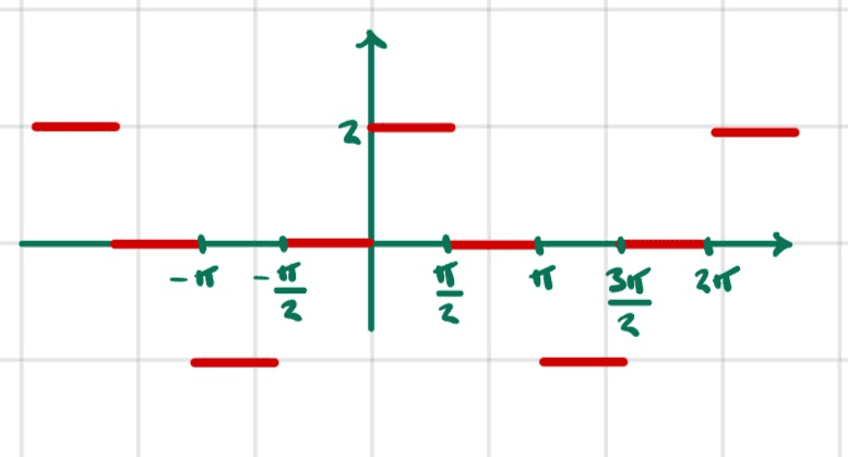

That being said, with only the definition and the information that it has (minimal) period ##2\pi##, the function could also be
Graph of a periodic step function on the x-axis from -2π to 2π: height 2 on (0, π/2) and 0 on (π/2, π), repeating with period 2π, with marked points at -π, -π/2, π/2, π, 3π/2 and 2π.
right?
