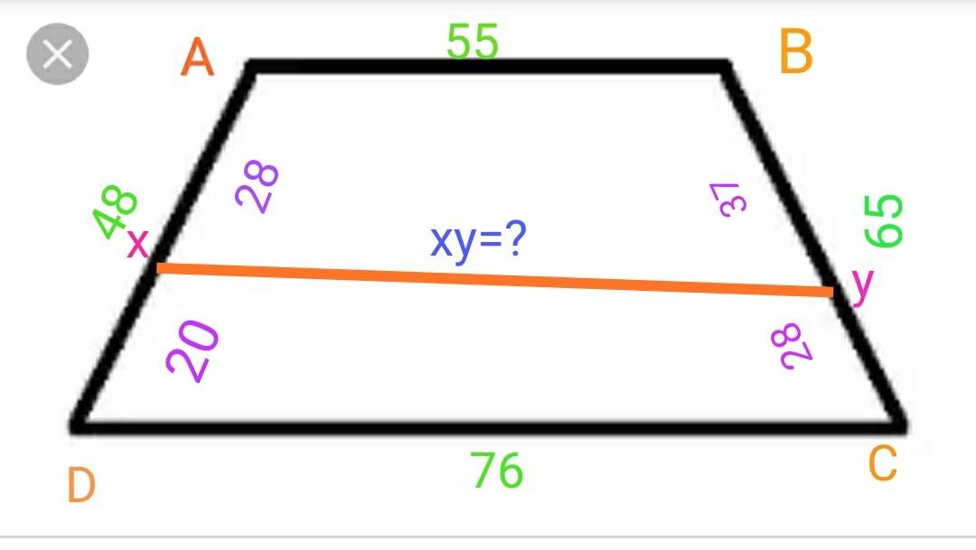

asmmanikanda
AB and DC not parallel line., AB=55,BC=65,DC=76,DA=48
Ax=28,xD=20,By=37,yC=28
How to find length of xy?

Yes sir. I posted rough diagram only sir. Your diagram may be your correct. My questions 1. How to find a length of xy if not trapezium?
2.how to find a length of xy if trapezium?
Can you post the original question here? If it has a diagram in the question, you can take a picture of it and upload it here, so we can get a better idea of what is being asked. :)
Image is in not to scale. 1. How to find length of xy if AB And CD is parallel ?
2.how to find length of xy if AB and CD is not parallel?
We can divide the quadrilateral into triangles like this.

Now we can repeatedly apply the cosine rule to find the various sides and angles.
The general cosine rule is:
$$c^2=a^2+b^2-2ab\cos\alpha \tag 1$$
And we can invert it to find the angle:
$$\alpha=\cos^{-1}\left(\frac{a^2+b^2-c^2}{2ab} \right) \tag 2$$
The length XY depends on the angle $\delta$, and its formula form is rather long, so I'm choosing not to write it out at this time.
If we have the constraint that we have a trapezium, then we have $\beta + \gamma = 180^\circ$ due to so called Z-angles.

Working through the cosine rules gives us then that $\delta \approx 137^\circ$, $\gamma \approx 30^\circ$, and $XY\approx 66.4$.
