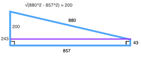

How to find the area of this irregular quadrilateral?

Srinivas said:
https://www.physicsforums.com/attachments/11884
How irregular is this? The picture makes it look like a right trapezoid, which has a known formula.
There may be a way to get the area of a quadrilateral using only the sides (like Heron's formula for triangles) but the only process I'm sure of requires knowledge of one of the angles as well. The usual method for finding the area of an irregular figure is to break it into triangles and find the sum of the areas of the triangles. If you have the angle of just one of these triangles you can find the length of the diagonal and can use Heron's formula to find the area of the triangle. Then you can get the other two angles and work from there.
-Dan

Two right angles.
Dan, two right angles are there in the image.

Okay, so this is not an irregular quadrilateral, it's a right trapezoid. The area for a trapezoid is $A = \dfrac{1}{2} (b_1 + b_2) h$. What can you use for the bases and the height?
It wasn't clear from the drawing that the angles at the base were right angles.
In any case, if you have an irregular quadrilateral you can find its area using Bretschneider's Formula - https://en.wikipedia.org/wiki/Bretschneider's_formula. However, in addition to the lengths of the four sides, you also need to know the measures of two opposite angles.

I think the first thing to do in this problem would be to determine if such a figure can be created with two right angles with the given dimensions.
243 ≠ 265
If I'm not mistaken, the quadrilateral in the picture cannot exist. Could you double check the numerical values of the problem, please? Just to make sure, we're talking about the right problem.
I think you don't have enough information to solve the problem from just the side lengths.
You can decompose the figure into two triangles. However, all you know about each triangle are the lengths of two of its sides. You need an additional piece of information - either the length of the third side (ie one of the diaongals of the quadrilateral) or an angle - in order to solve those triangles and so determine their areas.
