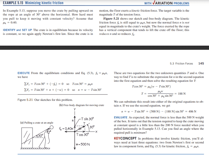

I have placed the problem as a picture. Just bevore 'Evaluate' it says find the angle where the required pull is minimum.
T = mu_k*w / ( cos(alpha) + mu_ksin(alpha) )
Can I get some help on how I'd do that?
I would parametrize the angle in the equation of where T = 188N and then take the derivative.
And then, what should I do then? it's not T' = 0 and I didn't have maxima minima vals in calc so yeah.
Thanks in advance.
##T = 188N## isn't relevant for the problem of minimising the required pull.

The expression you have for T is a minimum when the denominator is at a maximum. How do you find the maximum of that? Take the derivative, set it equal to zero and solve for the angle.

Why not ? Plot ##1/(\cos\alpha + 0.4 * \sin\alpha) ## to see there definitely is a minimum ...

it is isn't it? if I paramterize it by as a function of alpha ((nvm kuruman explained what you meant, it's only the denominator)
The 188 you mention is a function of ##\alpha##

oooh thanks, okay! makes total sense...

yes I should just take the derivative of the denominator instead of T itself as i did.
Can do that - but maximizing the denominator is less work :smile:

Derivative is -sinx + mu_k*cos(x) = 0
Can't really find a way to solve this to be honest.
Haha, how to solve ##\mu\cos \alpha-\sin\alpha = 0 \ \ ##:smile:
via
##\ sin(\beta-\alpha) = 0##

@BvU you know what works... just dividing by cos alpha and then we get alpha = arctand(mu_k) loll

acosx - sin x = 0
acosx/cosx - tanx = 0/cosx
a = tan x
x = arctanx
(didn't see the what, tried with double angle formulas,...) but I don't know why I didn't think of this at first...

I have to admit that is considerably quicker :smile:
But it's still a good addition to one's toolkit to know how to solve ##\ a\cos\alpha + b\sin\alpha = c \ ## :wink:
Another addition to the toolkit:
The angle that minimises ##T## is defined by ##\tan \theta_0 = \mu##, and the minimum ##T## is:
$$T_0 = \frac{mg\mu}{\cos \theta_0 + \mu \sin \theta_0} = \frac{mg\tan \theta_0}{\cos \theta_0 + \tan \theta_0 \sin \theta_0} = mg\sin \theta_0$$Also:
$$\tan \theta_0 = \mu \ \Rightarrow \ \sin \theta_0 = \frac{\mu}{\sqrt{1 + \mu^2}}, \ \cos \theta_0 = \frac{1}{\sqrt{1 + \mu^2}}$$Therefore:$$T_0 = \frac{mg\mu}{\sqrt{1 + \mu^2}}$$For ##\mu = 0.4## the man could have saved himself ##2N##.
