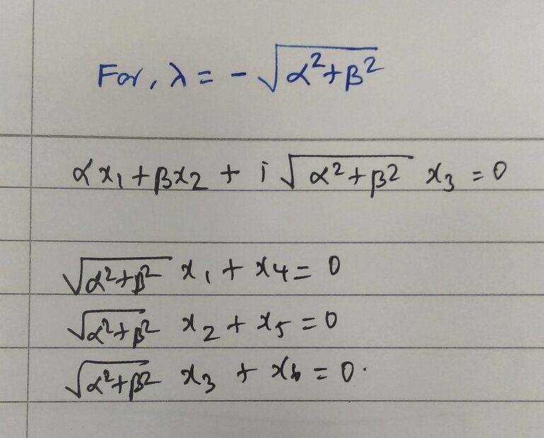

For λ = -sqrt(α^2+β^2), solving the characteristic equation in the matlab, the fourth column vector in M is displayed as solution. However if we manually do, we can get four equations as shown in the attached figure. And the first equation repeats three times meaning infinite solutions. The sixth column vector will satisfy the solution. But is it just a random vector? Or can it be attained as a solution.

When you have degenerate eigenvalues you usually pick three eigenvectors such that they are all mutually orthogonal. I think there are some typos in your original attachment in post #1. In a few instances if a ##k## were a ##k^2## then two eigenvectors would be orthogonal. The big picture message is that there is freedom in choosing the eigenvectors for a given eigenvalue with when its multiplicity greater than 1.

I solved for the two eigenvectors ##\vec v_1, \vec v_2## for ##\lambda = -k## the usual way, and I found that the system ##(A-\lambda I)\vec x = \vec v_i## was inconsistent for both eigenvectors. But that was okay because any linear combination of the two is still an eigenvector, and there is one that results in a system with a solution, namely the sixth column of ##M##. So it's not a random vector, but the one that allows you to calculate a Jordan chain.
I found the vector by setting up an augmented matrix where the seventh column was a linear combination of the two eigenvectors and row-reduced until I ended up with a row of zeros in the left six columns. Then I solved for coefficients that caused the corresponding value in the seventh column to vanish.
By the way, I noticed a typo: the bottom diagonal element of ##J## should be ##-k##, not ##k##.
