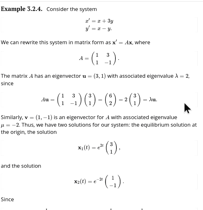

this is the example I am trying to follow
What do the third paragraph read, "similiarly,..."? Have you try to plugin in the second eigenvector to see if it is associated to the second eigenvalue? I.e. Repeated this line
$Au=\begin{pmatrix}-3&4\\ 3&-2\end{pmatrix}
\left(\begin{array}{r}1\\1\end{array}\right)
=\left(\begin{array}{r}1\\1\end{array}\right)
=\lambda_1\left(\begin{array}{r}1\\1\end{array}\right)
=e^{-5t}\left[
\begin{array}{r}1\\1\end{array}\right]$ with the second eigenvector. To see if the eigenvalue is the same?
