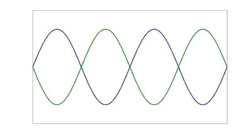

This was the first question. :( I found a picture that was suppose to go with the question (didn't get printed). Maybe that can help?
Yes the picture is extremely useful because tell us that the spring is fixed at its end and the wave is its fourth armonic. There are a lot of beautiful videos that could help you understandig what we are talking about: try searching on YouTube stationary waves.
The formula anyway says that \lambda = \frac{2L}{n} where L is the length of the spring and n the number of the armonic.
It's an interesting stuff, expecially if you are interested in music, so I suggest you to try to understand it on your own, or even better ask your teacher for some useful sources :)
Well that's great news, thank you so much. :) Now I'll just have to ask the teacher why he would make a question that we never could figure out if we only look at the compendium. :)
Looks as if you can now answer the question by just looking at the picture: how many wavelengths do you see ?
Wow, I did not realize that. :) Thanks for opening my eyes. :)
Just to be sure I didn't wrong-foot you: what is your conclusion?
λ = 2*3m/4 = 1,5m :)
Looks like the right answer to me !
