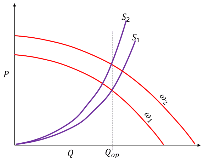

Are you using the fan curve, with fan laws to make your adjustments?
If your objective is to maintain ##Q_{op}## as the system curve transitions from ##S_1 \to S_2## via dust accumulation on the filter, you should use the manufacturers complete set of fan curves, or (less accurately) the fan laws to make your adjustment to rpm (##\omega_1 \to \omega_2##).

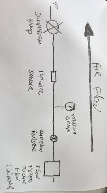

I attached my setup system. I am using flow meter hot wire sensor to control the pump.

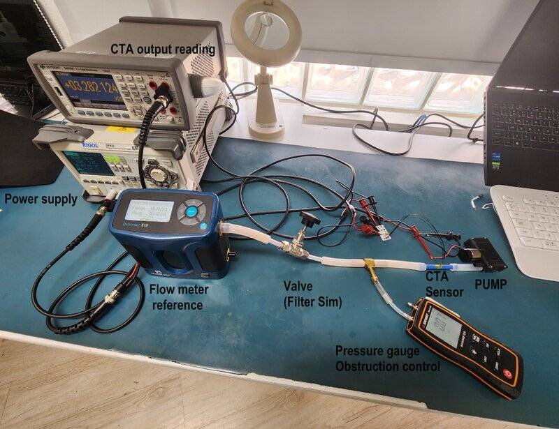

Thanks for you support jrmichier,
First of all the attached setup was create to validade my system, then the filter was changed by an air resitor, it is a valve then i can close and open to simulate filter obstruction. I can check the obstruction with the pressure gauge. I don' t have a pid, forwhile I am controlling the motor by dc power supply. The diameter of the tube is 6 mm and doesn't have any steaightening before the sensor, all the line is 6mm. I need to control the flow between 0.5 liter per minute to 5 liters to minute.

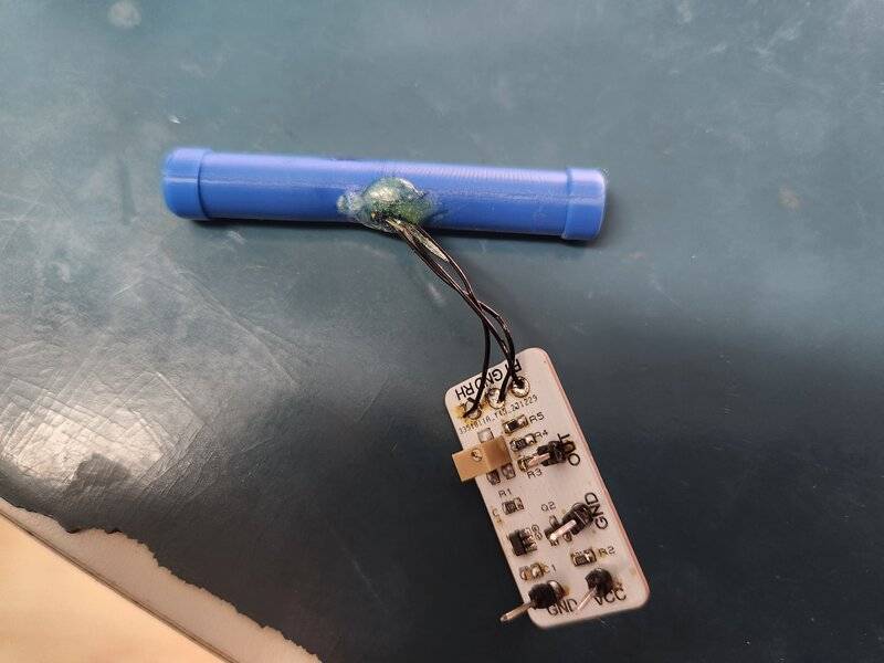

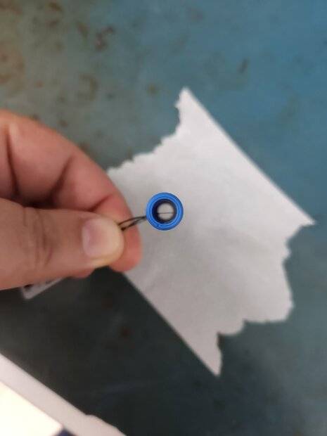

1) Your "air resistor" is apparently some sort of valve. A valve, any valve, disturbs the air flow. Hot wire air flow sensors do not work well with disturbed air flow. The disturbance will level out if there is a long enough length of pipe downstream from the valve. MUCH better is to have the sensor upstream from the valve.
2) How do you fit a 6.9 mm long sensor into a 6 mm tube? These sensors measure air velocity, and are designed to work in a smoothly flowing stream of air. If it is installed in a Tee fitting or an elbow, expect problems. Again, MUCH better is to have the sensor upstream from the valve. And in a straight section of pipe.
Please show us a detailed drawing or photo of the sensor installation.

You can see my setup and sensor setup in attached files.
If this sensor measures gas flow temperature to determine flowrate, we expect the temperature to periodically rise and drop in a PD pump because we expect the pressure to rise and drop over the displacement. You have a pressure gauge there, have you plotted pressure vs time to see the variation across the stroke?

Hi friends,
The problem here is the turbulence as jrmichler said. Now I will study about it to get the laminar flow inside the tube where sensor is. The device is small, then I don't have enough space to put the sensor far away from pump and inlet. I think a pulsation dumpner can improve the system.
