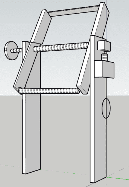

The apparatus is essentially two radial arms at about 1 foot separation, with an axle thru their centers and keyed to the arms and going thru bearings in a supporting frame at each end. At one end of the arms is an airfoil spanning the arms but at the other end is a symmetrical airfoil (no radial aerodynamic force) of the same mass as the test airfoil and spanning the arms. The former will generate an aerodynamic lift force acting radially and is an unbalanced radial force like an eccentric mass. I want to measure the lift force for several airfoil test pieces.
I now think I can do this by measuring the load at the bearing at one end of the axle and doubling it to get full load from the airfoil.
My on-line research suggests a load cell of the hydraulic type, to be connected between the end of the axle and the frame support. I have no experience with such equipment and am unclear as to how to manage the signal to see what I want which is the amplitude of the sinusoidal force. If the signal is voltage, maybe measuring it as an AC voltage would be enuff, altho I expect it would be the rms value. I could calculate max. value from that.
If you cannot visualize the apparatus, I can try to draw it using sketchup s/w and insert it as an image (later).
We really need a sketch. You do not need to use CAD - a simple pencil sketch is good enough. Make the sketch, photograph it or scan it to JPG, then paste it into your post using Attach files > Insert > Full image.
The test apparatus, omitting the base, the electric motor drive and belts from motor pulley to shaft pulley that is shown on the left side. It turns the rotor that has the test airfoil at one end (top) and a symmetrical airfoil, having the same weight, at the other end (bottom). The test airfoil generates lift from the tangential velocity and the force is radial, the vertical component generating a force sine wave as the rotor spins. I want to measure the amplitude of this wave.
On the right side of the support the axle goes thru a slot in the support to allow vertical movement. The upper support block is free to move vertically and houses the bearing for the axle and holds the upper threaded protrusion from the load cell underneath. The lower support block is fixed to the vertical support frame. From the load cell, which I assume is hydraulic, there are four wires. My guess is the following.
Bare- ground, White- neutral, Black- negative terminal, Red- positive terminal
I suppose a voltmeter for AC and connected from white to red will indicate an rms value for upward force. Connection from white to black will indicate rms value for downward force. Maybe vice versa.
BTW, I see a mistake in left rotor arm thickness. It should be uniform all along.
The measured value I can double to get total force values for the test airfoil.
Comments?

A major confounding factor is centrifugal force due to unbalance. Centrifugal acceleration is ##\omega^2*r## = ##(30*2*\pi)^2*6 inches## = 213,000 ##in/sec^2## = 550 G's. The maximum allowable unbalance weight is then 0.03 lbs / 550 = 5E-5 lbs, or 0.02 grams. Keep in mind that the airfoil will deflect due to the centrifugal forces, which will bend it outward and increase the unbalance force.
Also, the airfoil is running through air disturbed by the previous pass of the airfoil plus the rod opposite the airfoil.

At 250 ft/sec, there is significant kinetic energy in the rotating parts. This setup needs serious guarding and careful operation. The centrifugal acceleration is 1500 G's. That calls for careful design of the rotating parts, both for strength and deflection. And keep in mind that unbalance forces are exactly in phase with lift force, so it needs to be balanced both statically and at speed.
I suggest a button type load cell. Mount the bearing in a rectangular bearing housing that slides up and down in a slot in the frame. Set the load cell on the frame under the bearing block. Put a spring above the bearing block and preload it enough to hold the bearing block down onto the load cell. Size the load cell accordingly. Be aware that these load cells can typically tolerate an overload of 100% or so, and that anything more than that permanently damages the load cell.

The load cell needs to be stiff enough so that the mass of the rotating assembly and the spring constant of the load cell will result in a natural frequency well above 100 Hz. The Omega load cell data sheet gives deflection at full load, from which the spring constant is easily calculated. I know from experience that Omega sells top quality products, I have no experience with Sparkfun. The Sparkfun will probably meet your needs.
These are strain gauge load cells, which need a strain gauge signal conditioner. A good source of information to get started is: https://learn.sparkfun.com/tutorial...10.1853601799.1637959614-791085291.1637959614. You need a signal conditioner with at least 100 Hz bandwidth because the output is 3 dB down at the rated bandwidth. Sparkfun might have something, Omega certainly will. In either case, give them a call and ask for a strain gauge full bridge signal conditioner with at least 100 Hz bandwidth.
Concentrate on getting everything working before dealing with the signal. Also, do your first test runs with a dummy load cell to make sure that the spring holds the bearing block in place. If it hammers, even once, the load cell will be destroyed.
Are you studying a curved airfoil with the chord line on a 40 cm radius? If not, the average angle of attack could be zero, the leading edge could be stalled, and the trailing edge would be at significant negative angle of attack.
