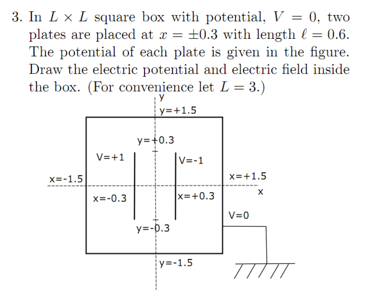

Physics problem diagram of a square box, labelled x = -1.5 to +1.5 and y = -1.5 to +1.5, with two vertical plates at x = -0.3 (V = +1) and x = +0.3 (V = -1) spanning y = -0.3 to +0.3, and the right edge grounded at V = 0.
To plot the electric potential and electric field, we should find the function about x, y.The attempt at a solution
I try to get E(ΔV/d) in x-axis, but no more development, to y and diagonal direction.
plus, Let me know how to use V=1, -1 plate, and V=0(boundary).
It just asks to draw the answer, so I think that trying to determine a "function about x, y" is more than it is asking for. Also, I don't see any conformal mapping that would give you such a function. You can use symmetry to determine some values on the y axis. I don't know what type of "drawing" would work well.
