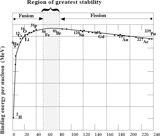

Watch This:
Graph of binding energy per nucleon in MeV against mass number A, rising steeply then peaking near iron-56 and declining slowly, with labelled isotopes and fusion and fission regions marked.
If you go to infinite A you cannot Have a finite fraction of charge hoping to bind the system. In fact infinite Nuclear matter is almost pure neutron matter in the Neutron Stars (also known as Pulsar).
You have to calculate for a specific region of interest, when you define "heavy nuclei"... I dunno, you can tell heavier then Pb to U...
You must try a definite A that you think heavy, you cannot do a limit to the infinite matter with the Weizsacker formula...
