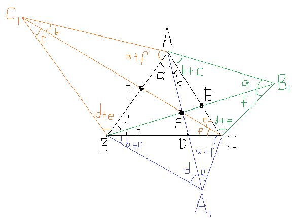

Here is this week's POTW:
Given that $A+B=C+D=E+F=\dfrac{\pi}{3}$ and $\dfrac{\sin A}{\sin B}\times \dfrac{\sin C}{\sin D} \times \dfrac{\sin E}{\sin F}=1 $.
Prove that $\dfrac{\sin (2A+F)}{\sin (2F+A)}\times \dfrac{\sin (2E+D)}{\sin (2D+E)} \times \dfrac{\sin (2C+B)}{\sin (2B+C)}=1$-----

Here is the solution of other:
Consider an equilateral triangle $ABC$, and let $D$ be on $BC$ so that $\angle BAD=a$, so $\angle DAC=\dfrac{\pi}{3}−a=b$.
Let $E$ be on $AC$ so that $\angle CBE=c$, so $\angle EBA=\dfrac{\pi}{3}−c=d$.
Let $F$ be on $AB$ so that $\angle ACF=e$, so $\angle FCB=\dfrac{\pi}{3}−e=f$.
By the sine version of Ceva's theorem and the given condition $\dfrac{\sin A}{\sin B}\times \dfrac{\sin C}{\sin D} \times \dfrac{\sin E}{\sin F}=1 $, $AD,\,BE$ and $CF$ are concurrent at a point, which we shall call it $P$.Extend $AD$ to points $A_1$ and $A_2$ such that $\angle A_1CB=a+f$ and $\angle A_2BC=b+c$.
We have $\angle CA_1A=\pi−\angle A_1CA−∠A_1AC=\pi−b−(e+f+a+f)=e$.
Similarly $\angle BA_2A=d$. Thus $\triangle APC$ is similar to $\triangle ACA_1$ and $\triangle APB$ is similar to $\triangle ABA_2$.
$\therefore \dfrac{AA_1}{AC}=\dfrac{AC}{AP}=\dfrac{AB}{AP}=\dfrac{AA_2}{AB}$, so $AA_1=AA_2$, so $A_1=A_2$.
Now $\dfrac{\sin{(b+2c)}}{\sin{(a+2f)}}=\dfrac{\frac{A_1P}{\sin{(a+2f)}}}{\dfrac{A_2P}{\sin{(b+2c)}}}=\dfrac{\dfrac{CP}{\sin{e}}}{\dfrac{BP}{\sin{d}}}=\dfrac{CP\sin{d}}{BP\sin{e}}$
Similarly, we get
$\dfrac{\sin{(d+2e)}}{\sin{(c+2b)}}=\dfrac{AP\sin{f}}{CP\sin{a}}$
$\dfrac{\sin{(f+2a)}}{\sin{(e+2d)}}=\dfrac{BP\sin{b}}{AP\sin{c}}$
By multiplying the three gives the desired equality$\dfrac{\sin{(2a+f)}}{\sin{(2f+a)}}\cdot\dfrac{\sin{(2e+d)}}{\sin{(2d+e)}}\cdot\dfrac{\sin{(2c+b)}}{\sin{(2b+c)}}=1 $
