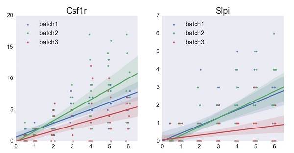

Below is another example image (for two genes). x-axis is the theoretical RNA input (with a small x-staggering to separate dots), y-axis is the molecule count. regression is mostly as a visual aid at this point...
<@mfb thanks for fixing my earlier image, I just copy-pasted your webscript to upload this one though I have to say I have no clue why it works>
Usually when people look at differences they do it to the mean or median or some other similar value. Doing this across multiple datasets is called an ANOVA in statistical lingo and there are many types of ANOVA depending on the assumptions of your distribution and your data.
If you are looking at noise then you need a model for said noise. There are models but they can be complicated depending on how equally complicated your process is.
The things that contribute to this are the decomposition of the residual itself along with any sort of covariance structure that may exist between observations and/or between the noise terms. This can actually get involved to the point where graduate statistics theory and knowledge is involved. If this is the case then you should really speak to a statistician or perhaps a PhD student or a TA or someone like that.
Models between random variables in terms of mean responses are called regression models. You need to specify the structure of the model before you pick the regression analysis methods (and execute them) but once you do you can get the results (usually done via statistical software like SAS or R) and use that to help form conclusions. The output needs to be understood not only in terms of the values but what assumptions you use to generate said results. If they don't work well and don't match up then your conclusions will be invalid and someone will likely pick it up. It helps to spend a little time on getting this stuff right. Regressions can help you model relations between two variables including linear and non-linear models in various ways. Any book on regression modeling will go through both theory and practice. If you are in a university your computers will probably have SAS which is what I recommend - especially if you've never done any programming before.
For the second point you need to determine whether data points are independent or not. If they are independent then one never determines the other. If they are dependent then you need to look at the joint distribution and use a statistical test to see whether your hypothesis holds. Again this involves making assumptions and understanding biology so that this understanding can be used to get statistical assumptions to come up with a model and to test hypotheses.
Usually what happens in statistics is that you measure a parameter which is tied to some distribution assumptions. A sample contains information that is used to estimate said parameter and the higher the information content in the sample, the better the estimate is. If you are figuring out means then you use the central limit theorem when the sample size is large enough (basically any time you use an expectation in some way). Independent data points increase information and you can use this idea to figure out how much data you need to get a good enough interval for estimating your parameter.
I know this is a lot to take in but it will help you down the road. Making mistakes will screw up your analysis and if you publish a paper using said results and they are wrong then you will wasted some time - which is why I recommend you speak to a statistician, PhD student, TA, or RA in addition to finding out about ANOVA and Regression Models.
If you have other specific questions I can do my best to answer them.
