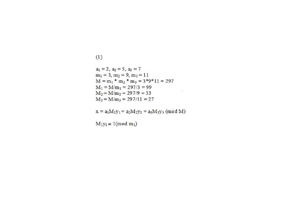

  • Handwritten-style worked solution for a Chinese Remainder Theorem problem: a1 = 2, a2 = 5, a3 = 7; m1 = 3, m2 = 9, m3 = 11; M = 297; M1 = 99, M2 = 33, M3 = 27; then x = a1M1y1 + a2M2y2 + a3M3y3 (mod M), and M1y1 = 1 (mod m1), marked to be continued.

  • Worked Chinese Remainder Theorem setup: a1=2, a2=5, a3=7; m1=3, m2=9, m3=11; M=297; M1=99, M2=33, M3=27; then x = a1M1y1 + a2M2y2 + a3M3y3 (mod M) and M1y1 ≡ 1 (mod m1).

The approach is correct.
However, a precondition of CRT is not met.
That is, it requires that the $m_i$ are pairwise co-prime.
Since $m_1=3$ and $m_2=9$ are not co-prime, we need to do something about that first.
Observe that any solution of the second equation with $m_2=9$ satisfies the first equation (with $m_1=3$).
So if we leave out the first equation completely, we will find the same solutions, and we satisfy the precondition of CRT.

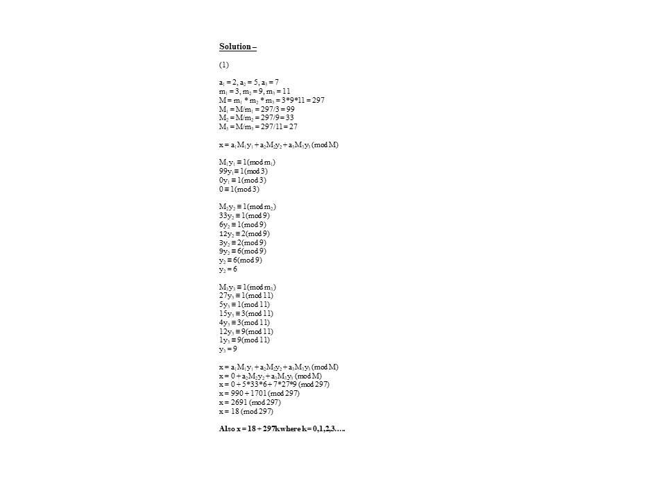

Please check for my solution draft paper -
  • Typed worked solution to a Chinese Remainder Theorem problem with moduli 3, 9 and 11, finding x = 18 (mod 297) with the general solution x = 18 + 297k.

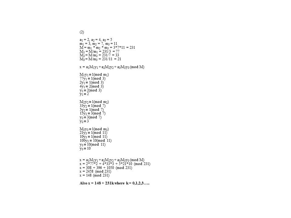

  • Handwritten-style worked solution of a Chinese Remainder Theorem problem: a1=2, a2=4, a3=5; m1=3, m2=7, m3=11; M=231; then M1=77, M2=33, M3=21; solving each congruence for y1=2, y2=3, y3=10; final x = 148 (mod 231).

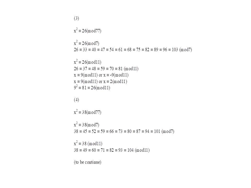

Please help me for question (3) and question (4)
(I need urgent assistance for this exercise)
  • Handwritten-style worked solution listing: x^2 ≡ 26 (mod 77) split into x^2 ≡ 26 (mod 7) and x^2 ≡ 26 (mod 11), with candidate lists, x ≡ 9 or 2 (mod 11), and x ≡ 38 (mod 77) split into mod 7 and mod 11 candidate lists, marked to be continued.
Did you check by filling in your solutions in the original equations?
You should find that (1) does not fit.
Your solution is wrong, because the set of equations does not satisfy the precondition of CRT that the $m_i$ must be co-prime.
You should find that (2) does not fit.
Everything is correct, except for a calculation mistake at the very end.
It should be:
$$308+396+1050 \equiv 1754 \equiv 137 \pmod{231}$$
I'm not quite sure what you did for (3).
Your approach seems to be correct, but in the first step, we should have:
$$x^2\equiv 26 \pmod{77} \quad\Rightarrow\quad x^2\equiv 26 \equiv 5 \pmod {7}$$
Checking $x\equiv 0,1,2,3,4,5,6 \pmod{7}$ shows that there is no solution.
Same thing for (4).
$$x^2\equiv 38 \pmod{77} \quad\Rightarrow\quad x^2\equiv 38 \equiv 3 \pmod {7}$$
Checking $x\equiv 0,1,2,3,4,5,6 \pmod{7}$ shows that there is no solution either.
