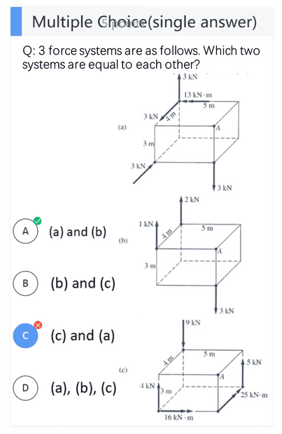

I am currently learning Theory Mechanics, and I am always troubled on this kind of problem for don't know how to add 3D torques. Can anyone tell me how to solve this kind of problem / i.e. a general step-by-step solution to such problems?
M=r×F
I believe you calculate 3 different torques (about x,y, and z axis) and arrange them in a vector.
You do this for each picture.
Compare and contrast.

Actually it would be much easier to use the cross product and since the torque is about point ##A## the individual torques are
##\vec{\tau} = \left( \vec{r} - \vec{r}_A \right) \times \vec{F}##
I hope you don't mind if I call ##\left( \vec{r} - \vec{r}_A \right)## by a different letter to condense it. Let ##\vec{R} = \left( \vec{r} - \vec{r}_A \right)## so ##\vec{\tau} = \left(\vec{R} \right) \times \vec{F}##.
I'll get you started on the first torque to calculate in diagram ## \left. a \right)##. I'm going to calculate the torque due to the upward ## 3 \cdot 10^3 \text{ kN}## force at the back top left corner of the rectangular prism.
##\vec{R} = \vec{r} - \vec{r}_A = \left(0,0,3 \right) - \left(4,5,3\right) = \left( -4,-5, 0\right)##
For that particular ##\vec{F}## we have ##\vec{F} = \left(0,0,3 \cdot 10^3 \right)##
Find the cross product of the two above quantities to get your first torque about point ##A##.
##\vec{\tau} = \vec{R} \times \vec{F} = \left( -4,-5, 0\right) \times \left(0,0,3 \cdot 10^3 \right) = \left(-1.5 \cdot 10^4 , 1.2 \cdot 10^4 , 0 \right)## (hopefully I did that right)
Let me know if you need help remembering how to do cross products.
@nightsailor833
I'm getting an answer that corroborates the answer shown as correct on your homework.
for situation ## \left. a \right)## I'm getting
##\sum \vec{F} = \left( 0,0,0 \right)##
##\sum \vec{\tau} = \left(-1.5 \cdot 10^4 , 8 \cdot 10^3 , 0 \right)##
for situation ## \left. b \right)## I'm getting the same as I got for situation ## \left. a \right)##
for situation ## \left. c \right)## I'm getting
##\sum \vec{\tau} = \left(0, 0 , 0 \right)##
Thus corroborating the given correct answer that situation ## \left. a \right)## and ## \left. b \right)## are equivalent whereas ## \left. c \right)## is not.
Instead of doing each cross product out by hand I used this site https://www.wolframalpha.com/input/?i=cross+product+calculator

Did anybody told you the meaning of those consecutive two arrow heads that are shown in systems a and c?
Lnewqban said:
Welcome, @nightsailor833 !
I believe they are torques as noted by their stated units of ##\text{kN}\cdot \text{m}##.

Given a force ##\vec F##, its torque ##\vec \tau## about a point P, and the displacement ##\vec s## from P to another point P' we can calculate the torque about P'. Consequently, if we pick the same origin O for each force system then knowing the net force and the net torque about O for each is enough to determine whether they are the same.
It may be convenient to choose O such that several forces pass through O. This makes their torques zero.
I assume you know how to write each torque, force and displacement as a vector and compute the vector products to find the torques of the forces.

Correct, but considering the direction of the represented torque is important.
That question was for OP specifically.
Please, see:

@Lnewqban I assume this is a statics/dynamics class question. I’ve never taken those classes myself. In the course of answering this question I watched some YouTube videos and pieced together what I thought was reasonable and it turned out to corroborate “situations a and b are equivalent whereas c is not” (maybe it’s a coincidence)
If you worked it out did you get the same answer as me in #4 ?
May I PM you my work to see if my approach is valid?
The long and short of it is that I assumed.
Forces produce torques that you must take into account in the summation of torques.
BUT
Although some torques are given you don’t have to figure out the force that produced them and account for them in the summation of forces.
This seems paradoxical but it gave a qualitative correct answer.

Right. You do not have to suppose that torques arise from forces. Mathematically, you can just take it that torques can exist by themselves. But if you are more comfortable with the "everything is forces" view, you can represent a pure torque by a pair of equal and opposite forces that are antiparallel.
Note that a pure torque exerts the same torque about every point in space. If ##\vec F## and ##-\vec F## are ##\vec r## apart then the torque about point ##\vec s## relative to the former is ##\vec s\times\vec F+(\vec s-\vec r)\times(-\vec F)= \vec r\times\vec F##

"because each torque can be represented as through 2 equal and opposite forces at the same distance in different directions the forces cancel out and don't have to be included in the summation of forces"
torques still have to be included in the summation of torques.
Basically there are no extra forces to include from provided torques because they can be conveniently represented in a way such that they (the forces provided the torque) cancel out.
