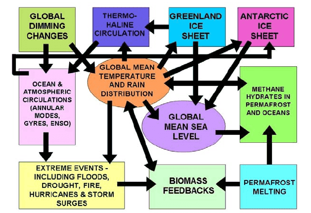

Hello,
I want to study a system, and I have realized that all variables in it are dependent. There is no independent variable. So everytime you modify the input, you get an output but at the same time that output modifies the input itself, there is an important feedback. So the system apparently is evolving searching a kind of equilibrium but it does it in several steps and I find it difficult to "isolate" one variable, or analyze what is the relationship between variables since they are affected by the rest of the system.
I will try to put an example, hopefully it will show the main characteristics I am talking about.
In the atmosphere if there is a raise in the amount of energy that arrives from the sun, the temperature raises. But that changes the amount of water the air can contain, and that modifies the amount of radiation that the atmosphere absorbs which is the factor we started analyzing.
My question is, What is the best mathematical tool to understand systems where feedback between variables is key?
Another example:
Flow diagram of interlinked climate system components with two-way arrows, including global dimming, thermohaline circulation, ice sheets, global mean temperature and rain distribution, sea level, methane hydrates, biomass feedbacks and permafrost melting.
Would you use differential equations? Variational calculus?
It has nothing to do with Chaos theory unless the system happens to be chaotic, and many systems as complex as the OP's picture are not.
Differential equations, signal processing (analog and digital), and control systems (stability analysis, etc) would be good topics to start learning. You may need some probability theory as well.
With 'feed back', this would be "non-linear differential equations" or, more generally, "non-linear analysis".
It's not 'chaos theory' you are looking for, but 'control theory' which deals with inputs to dynamical systems and the resulting feedback:
http://en.wikipedia.org/wiki/Control_theory
It's not a branch of pure mathematics which deals with feedback, but a blend of math and engineering, an inter-disciplinary effort.

Well, I don't know if the system is chaotic or not. It is complex for sure. I guess a small change could have a big impact on other variables but this is only guessing.
Thanks, I will try to learn that.
