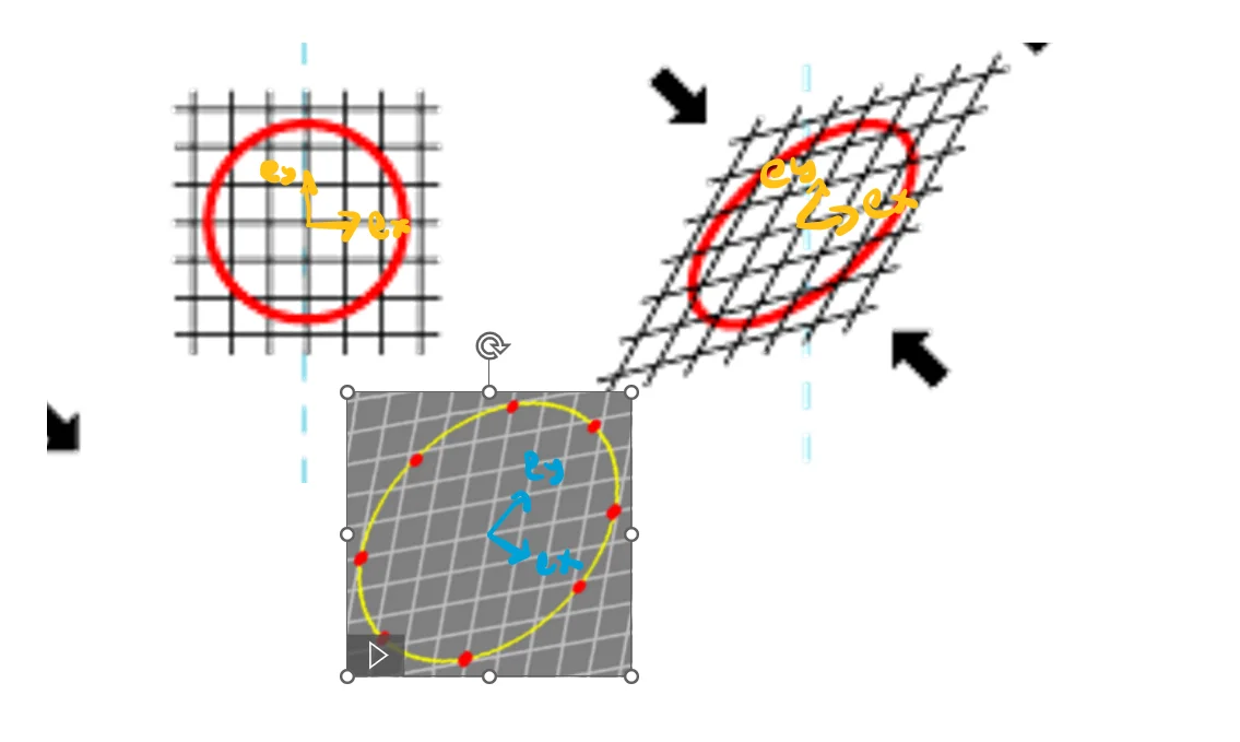

The matrix term is clearly a rotational transformation, but I have problems to understand how the transformation looks like and what vectors we transform.
If we have a sandwich plane gravitational wave on the flat background, then in front of the wave, the space-time is flat, so the metric is Minkowskian and the basis vectors ##e_x## and ##e_y## are ortonormal to each other in the flat metric. Then the wave comes and let's say that it is X-polarised. Since the Rosen metric is comoving with rest particles, the basis vectors ##e_x## and ##e_x## will be stretched with the space-time.
The metric in which the basis vectors point in the direction of the principle axes of the ellipse (shown in the picture below) is ##\mathrm{d}s^2 = 2\,\mathrm{d}U\,\mathrm{d}V + e^{2\beta}
\begin{pmatrix} \mathrm{d}x' & \mathrm{d}y' \end{pmatrix}
\begin{pmatrix} e^{2\gamma} & 0 \\ 0 & e^{-2\gamma} \end{pmatrix}
\begin{pmatrix} \mathrm{d}x' \\ \mathrm{d}y' \end{pmatrix}##. And here comes my confusion - the transformation matrices ##R## and ##R^T## rotates the basis, in which the metrix is diagonal, back to the basis, in which the metric ##g_{ij}##,where ##i,j=1,2##, can have non-diagonal components. But the "diagonal basis" must have perpendicular vectors so that these vectors point in the same diretion as the principal axes of the ellipse. But the rotation must preserve its perpendicularity. But the "non-diagonal basis" is oblique as shown in the picture, so there is a contradiction.
The general metric can have non-diagonal components, that is the metric with respect to the "oblique" basis, the stretched basis. But its rotation doesn't ensure that its two vectors point in the same direction as the principle axes. So, what basis do we rotace exactly? Because this looks like we rotate the "perpendicular flat basis" by ##\alpha##. But that doesn't make sense because then we can't get the oblique basis.
I tried to visualise my thoughts in this picture. I hope it clarifies what I mean.

You mean it is also a stretching by ##e^{2\beta}##? But ##e^{2\beta}## could be given inside the matrix and then it is only a rotation. Right?
I suspect Dale is referring to the ##\mathbf{R}^T\mathbf{MR}## structure, which looks like a rotated "stretch and squish" to me.
Oh, you mean ##e^{2\gamma}## and ##e^{-2\gamma}##? Ok, that characterisises the anisotropy of the space-time. So ok, the basis of the flat space-time is stretched and squinshed and then rotated. But that means that the basis vectors should be perpendicular to each other, because rotation doesn't change angles between vectors. But our basis is oblique...
No, ##\mathbf{R}^T\mathbf{MR}## is a rotation, a stretch/squish, and an inverse rotation. That doesn't preserve perpendicularity, as you can easily see by multiplying out the matrix - it has off-diagonal elements that will give you a ##dx\, dy## term.
So we can essentially say that the diagonal matrix corresponds to the metric with basis vectors ##e_x## and ##e_y## pointing in the principle axes of the ellipse. And by transforming the metric with ##R## and ##R^T## we rotate these axes by ##\alpha##, which with the final metric creates the oblique basis?
I tried to visualise my thoughts:
Rotation, stretching, and rotation is not equivalent to just rotation. Angles do change.

I think that my mistake was that I tried to give the angle ##\alpha## a physical meaning. The angles between the oblique and the transformed basis don't have to be ##\alpha##. This angle is just a way to parametrize the metric. For a X-polarised wave the angle would be ##45^\circ## and the picture would be just a rotated ellipse in the Euclidean plane. We can visualise the angle in the Euclidean plane as an angle between a rotated and non-rotated orthogonal Euclidean base. Is this idea correct?
I don't think so. I think your mistake was trying to give ##\alpha## the wrong physical meaning.
As I noted in post #11, ##\alpha## is a function of ##U##. That means it changes along the wave. It is not a constant. Your visualizations appear to me to assume that it is.
The physical meaning of ##\alpha## is that it describes the phase, changing along the wave, of the rotation in the ##x## - ##y## plane. The paper you referenced calls this the "polarization angle".

I know that it can change with ##U##, but my initial idea was that it is the angle between the oblique basis and the "principal axis basis". But I suppose that is not true in general. It is just an angle between Euclidean basis vectors.
It's the angle, which changes along the wave, between the ##x## - ##y## basis and the principal axis of polarization of the wave.
I'm not sure what you mean by this. Unless ##\gamma = 0## (no shear), the geometry of the ##x## - ##y## plane is not Euclidean.
