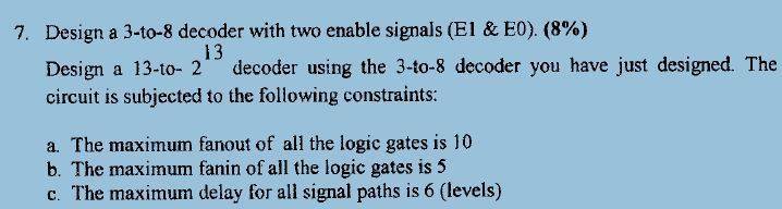

tonald Messages 6 Reaction score 0 Thread starter Dec 20, 2009 #1 I have no idea about how to use two "enable inputs". (the second part of the question) Attachments ??.JPG 22.1 KB · Views: 466
berkeman Admin Messages 69,839 Reaction score 25,780 Dec 21, 2009 #2 tonald said: I have no idea about how to use two "enable inputs". (the second part of the question) When neither of the enable inputs is asserted, all of the outputs are disabled.

Wo0p Messages 14 Reaction score 0 Dec 21, 2009 #3 If you're stuck on implementation, I advise you to study the 74LS137 3-to-8 decoder :)
berkeman Admin Messages 69,839 Reaction score 25,780 Dec 21, 2009 #4 Wo0p said: If you're stuck on implementation, I advise you to study the 74LS137 3-to-8 decoder :) Actually, since the question doesn't require address latches, it might be easier for them to study the 74xx138 IC. Good suggestion, though. (xx = HC, AC, LS, whatever).
