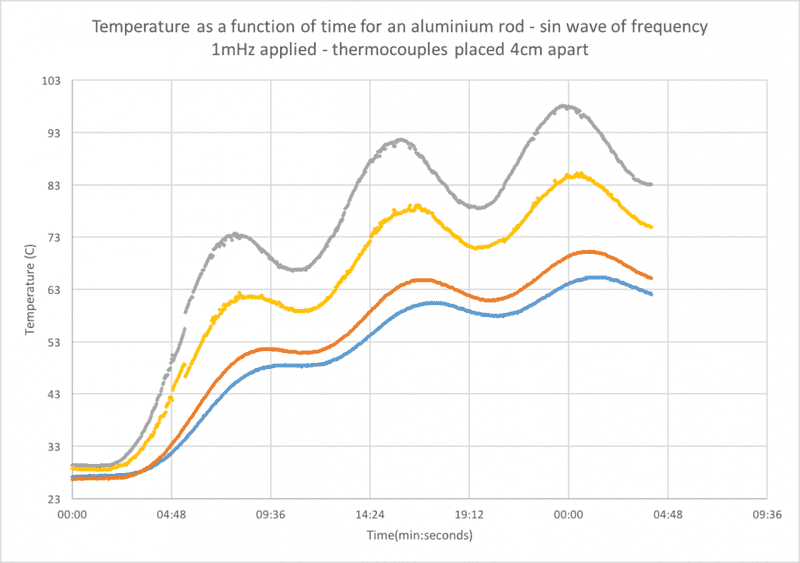

I've attached a graph of one set of the results I've obtained, please ignore the lack of formatting as this is still a process undergoing!
The image shows our results from an aluminium sample with the heating element working at a frequency of 1mHz. The thermocouples were placed every 4cm with the first one 4cm from the heating element.
I rearranged your equation for thermal diffusivity and obtained a result of 9.5e-3 but the true value is 9.7e-5. This makes me think I've made a calculation error somewhere?
With regards to the graph, each trend line represents the values from one of the thermocouples, each one with lower amplitude representing an extra 4cm along the bar.
I very much took estimates from the graph for temperature and time. If you haven't received it in a readable format please say and I will try to send again in a different type of file.

Yes, this is my solution to the transient heat conduction equation, but I omitted the heat loss term. I can see from your data that the heat loss term is significant. The equation I derived describes the behavior at long times, when the average temperatures have leveled off. Do you have any data at such longer times? Analyzing the results during this transient period (before dynamic steady state has been achieved) requires a much more elaborate solution and game plan for comparison. In my judgment, you were supposed to have waited long enough for dynamic steady state to be achieved.
It looks from your graph that the period of the oscillation is about 10 minutes. How does this relate to your 1 mHz forcing. Is mHz milli-Hertz?
I have another question. The heat flux at z = 0: It is constant, plus a superimposed sinusoidal variation?

Using you solution to the heat equation I've actually got some correct answers. I think you are most certainly right that we were suppose to wait for it to level off. However to counter for this, when taking amplitudes for each "line", I have taken the zero point at different places; where the relative amplitude is zero.
