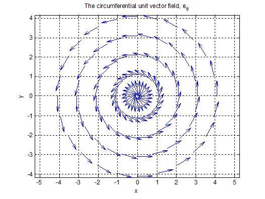

Let's say we have a vector field that looks similar to this. Assume that the above image is of the x-y plane.
The vector arrows circulate a central axis, you can think of them as tangents to circles.
The field does not depend on the height z.
The lengths of the arrows is a function of their radial distance from the center/axis, f(r).How do we write this vector field in terms of Cylindrical coordinates?
##A_\rho \hat{\boldsymbol \rho} + A_\varphi \hat{\boldsymbol \varphi} + A_z \hat{\mathbf z}##
How does one find ##A_\rho , A_\varphi## and ##A_z ## ?
Vector V = (Aφ)* unit vector φ, where Aφ = f(ρ) with Aρ = 0 and Aρ = 0 and Az = 0
thanks!
But what do you mean by "with Aρ = 0"?
Also, can you describe how the cylindrical unit vectors work? You can post a link if you like.
Aρ = 0 and Az = 0 means the component of the vector field along ρ unit vector and along z unit vector both are zero.In other words vector field every where is perpendicular to ρ unit vector and z unit vector and is entirely along unit vector φ.
