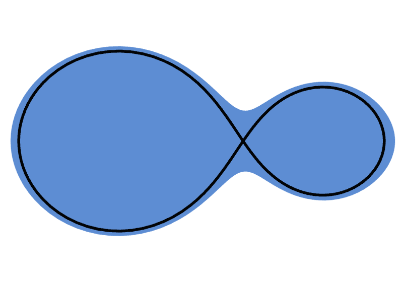

For sizes of Roche lobes see the approximations at https://en.wikipedia.org/wiki/Roche_lobe
q is in the range between 2 and 10?
For q=8, I get r1/A around 1,96/(2,4+ln3) which is close to 0,6. So at "million miles", Sun should not fill its Roche lobe. And on your images, the distance looks rather bigger than a million miles.
Now suppose Sun does have a dense companion and does fill its Roche lobe. How would Sun evolve?
In the absence of Roche lobe, what Sun is doing on main sequence is slowly accumulating He, with the result that it slowly brightens and expands already on main sequence. (When subgiant and giant, brightening and expansion will be fast).
In the presence of Roche lobe, if Sun at 1,00 solar masses slowly brightens and spills over mass to its red dwarf companion, Sun becomes less massive and therefore dimmer. Gradual loss of mass will counteract the gradual buildup of He and thus counteract increase of luminosity, in long term!As for density: no, ignition of fusion at the start of main sequence does not cause a dramatic decrease of density. It stops a gradual increase of density and stabilizes the density at its main sequence levels.
