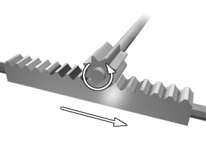

Would you be able to provide an explanation and an example of how rack and pinion can be used in a robotic / exoskeleton arm to convert rotary motion of an electric motor into linear motion when lifting / moving objects linearly with the arm / hand? How / where would the rack and pinion be assembled relative to the arm and how would the rotary motion of the motor be transmitted?
It's not wise to attempt to do mechanism design via email or forum. You original question was rotary-to-linear, wasn't it? An idea for rack & pinion: the rack is attached to cables, around a pulley, which is attached to pivot links for angular motion of the pivoted link. But it seems more complicated than other suggestions.

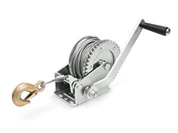

Here's the common man's tried and true rotary to linear motion converter.
Note it's a variant of rack and pinion, just the rack is wrapped around a spool..
Or you might think the other way - rack and pinion is just spur gears with one of them straightened out.
