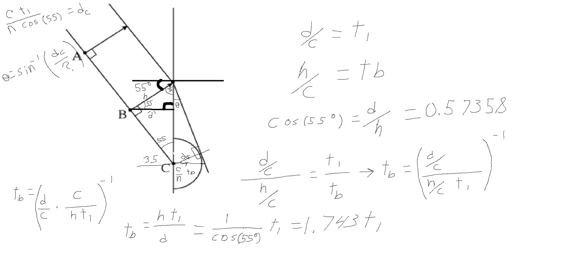

Part A was simple enough, if the distance traveled in the new medium takes place over the same amount of time in the old medium, then the distance traveled will be the new velocity divided by t1, which makes d'= (c/n)*t1.
Part B is t1/cos(55) = tb
Part C is (c/n) * tb
Where I'm getting a bit hung up though, is part D
The hint given for it is Huygens' principle relies on looking at each point on a wavefront as a source of circular (two-dimensional) wavelets. As a result, we can look at how a wavelet propagates from where point C touches the interface. While this wavelet is propagating in the material (at a speed less than c), point B of the wavefront continues to propagate at speed c until it too hits the interface. When this occurs, one can draw a line from the point at which B touches the interface to the tangent of the wavelet from point C earlier. Since this line is tangent to the circle, it is perpendicular to a line from where point C touched the interface (i.e., the center of the circular wavelet) to the point of tangency (on the circular wavelet). From geometry and the previous part, one should be able to deduce the relevant angles. Note that the distances from point C to points B and A are arbitrary and thus can be considered very small.
The diagram for this problem (which I have taken the liberty of doodling on while I work this problem) is below. I think I need to find a relation where I know the distance from point C to where the ray from point B meets the interface, thus giving me some quantity for the hypotenuse, but I am not sure what that is?
