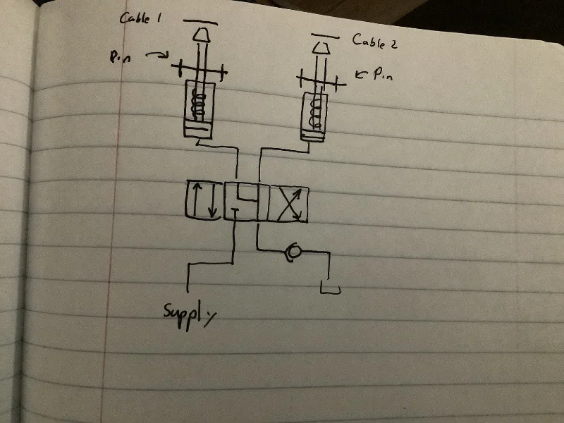

Hydraulic cylinder encountered in a system is held in place with a pin that catastrophically fails once its shear force is reached, at which point the cylinder actuates. What benefit does this add to the application described below.
I have encountered a vertically oriented hydraulic cylinder that is designed to actuate and slice heavy cabling into sections with a blade. The cylinder is quite small (around 1.5 inches in diameter) and has an equally small stroke. The cylinder is single acting (i.e. it is pressurized from the bottom, and vented to atmosphere with a spring return, roughly 200lbs of force on the spring). The system operates at roughly 2500 psi.
Interestingly, the cylinder has a pin that passes through its piston Rod, as well as the housing mounted around it, that prevents the cylinder from moving initially. When the control valve is actuated, fluid is ported to the bottom of the cylinder, pressure builds extremely quickly (as expected) and the pin shears, allowing the cylinder to actuate.
Long story short, we are looking into redesigning this machine, and nobody can seem to determine what the purpose of this pin is (the old designers with the knowledge are no longer with us). From a hydraulics standpoint, at full flow the cylinder should move instaneously and at the speed dictated by the flow, regardless of whether or not the pin is in or not, so I don’t see the benefit of building pressure behind the pin to meet the shear pin force and then allowing it to fire the cylinder. Is there an advantage gained in potential “impulse” by doing this? Any theory I can think of says no (hydraulics don’t expand like gases), but then again I’ve seen hydraulic presses accelerate after being at stall briefly once they destroy whatever is under them.
I suppose along those lines I’ll ask the theoretical question: What would the outcome be if you theoretically held back a cylinder maintained at a set pressure with a load, and then suddenly (almost instantly) removed the load allowing the cylinder to extend? Would it jump forward faster or show jerky motion?
The cylinder does contain cast iron rings and wave washers, presumably because of the shock of the cylinder slamming in the extended position.
Asking more so out of curiosity why such an arrangement would exist.

The application is to sever a cable in the event that an item becomes fouled/unusable.
There is no accumulator in the cylinder. There is an accumulator in the relatively large, multi loaded hydraulics system that is feeding it, but not in the cylinder.
We have ran analysis considering that pin may prevent drift, but given the way the system is set up, the only drift would come from a leaky control valve…..but when centered the valve is fully connected to tank, which would be the path of least resistance. Also, any back pressure that may come from the return (which shouldn’t even be there) would not be able to overcome the spring force that holds the piston down, and there are multiple check valves in the line back to tank. We have essentially ruled out the possibility of it being for cylinder drift and accidentally cutting the cable.
This has been a head scratcher for us, because like you have said hydraulics can’t store energy in the same manner as a gas.

So when the cylinder is fully reset, the fluid is pushed out of the bottom into the reservoir circuit. The same control valve controls two of these; when actuated in one direction it cuts one cable, when it goes the other way, the other. It is a float center valve and keeps the bottom of each cylinder at low pressure when at rest. I have attempted to attach a sketch of the hydraulic diagram and general setup for reference.
We struggle to see how drift could be a an issue with this setup.
Ok. Depending on the system, sometimes the return can have a slight pressure. Don't be too sure that the main return doesn't have some residual pressure from flow from other circuits as they flow back to the reservoir.

Thanks, understood. We have done some analysis and found the possibility of occasional back pressure in the return, but there are multiple check valves in the system return at multiple spots (including right downstream of the valve exit). The back pressure would have to be somewhat significant to overcome the spring force in the cylinder as well.
How far would you expect the vented system to move without the shear pin, when climbing or descending from altitude?
If the cylinder is only connected from below, then how is air bled from below the piston in the cylinder, or does air remain in the cylinder to act as a hydraulic accumulator?

I’ll throw another wrench in the scheme, and say that this portion of the system is all stainless steel, seamless hydraulic piping (no hoses)……
I sketched up a simplified hydraulic schematic, and attached.
Even the piping has some stretch. Also, what about all the way back to the pump? Curious about how this project is coming.
