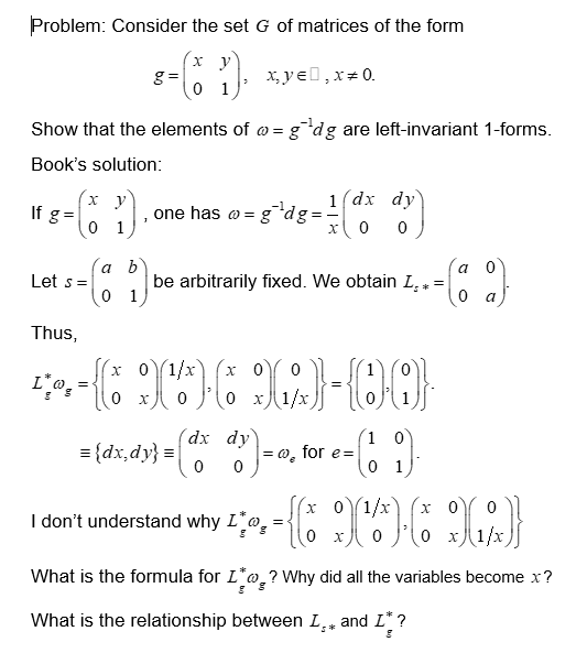

I am doing self study on differential geometry
I understand everything until author calculated the pullback of the one form
How did he get the result for L*g wg?
I am doing self study on differential geometry using Analysis and Algebra on Differentiable Manifolds by Gadea. I don't understand the step where he calculates the pullback of the left translation of the one form. Why did all the variables become x? What is the formula for the pullback on w?
I have tried many hours on that step. Is Lg upper star equal to Ls lower star? Please help, I really appreciate it.
The formula is ##L^*_g\omega_g=\omega_g \circ L_g.## That explains the second half of the equation. I think
L^*_g\omega_g=\left\{\begin{pmatrix}x&0\\0&x\end{pmatrix}\begin{pmatrix}1/x\\0\end{pmatrix}\, , \,\begin{pmatrix}x&0\\0&x\end{pmatrix}\begin{pmatrix}0\\1/x\end{pmatrix}\right\}
is simply the coordinate notation of vectors in the tangent space. The tangent space is spanned by ##dx=\begin{pmatrix}1\\0\end{pmatrix} ## and ##dy=\begin{pmatrix}0\\1\end{pmatrix}.## ##\omega_g## contributes the factor ##1/x## and ##L_g## the left-multiplication. I wouldn't have switched to coordinates and had simply written
L^*_g\omega_g=\omega_g \circ L_g=\dfrac{1}{x}\begin{pmatrix}dx&dy\\0&0\end{pmatrix}\cdot \begin{pmatrix}x&0\\0&x\end{pmatrix}=\begin{pmatrix}dx&dy\\0&0\end{pmatrix}=\omega_e
##x## comes as coordinates of ##g.##
