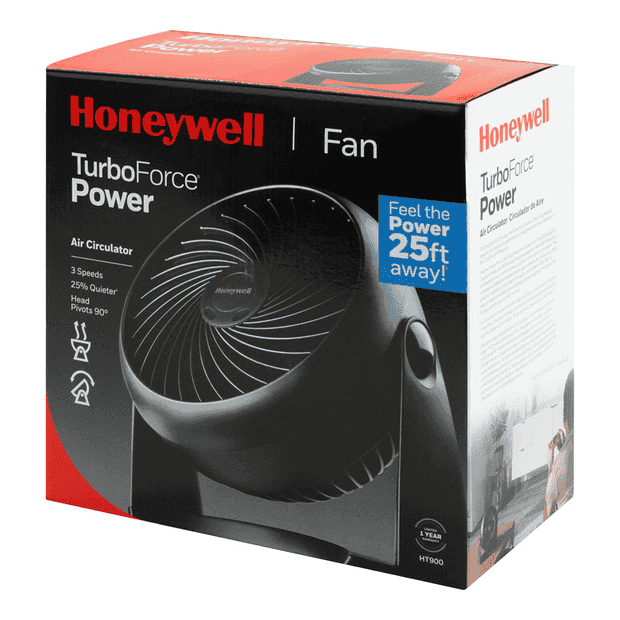

oh i just have a couple honeywell fans. they make the same amount of noise as when they were new, i just wish i could have something that makes very little noise so i could here people talking on tv with the volume low.

Further Information on the 3 speed Honeywell HT-900 TurboForce Air Circulator.
Maximum Cubic Feet per Minute: 185 CFM.
Wattage, ‎35 watts ; Voltage, ‎110 Volts ; Is Dishwasher Safe, ‎No.
Uniquely engineered fan blades provide quiet, powerful personal cooling that’s great on a tabletop or mounted to the wall in your home or office.
Engineered to be 25% Quieter.
Unique blade design creates less noise but remains powerful – feel the TurboForce from up to 25 ft. away!
