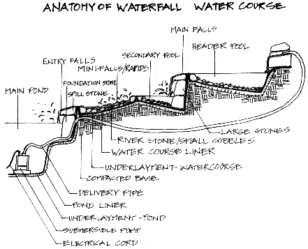

I would use a multi-level «waterfall-pool» set up. All you need is to put an open reservoir at one end of each of the bed pipes. The input flow should arrive horizontally at the top of the reservoir and there should be an overflow feeding to the next lower bed. This way the pressure in the pipe will be controlled by the depth of the reservoir, not by the height of the cistern.
For it to work, you need either a valve at the entry of each reservoir controlled by a floater in the reservoir or one valve at the cistern controlled by a floater in the lowest reservoir.
To better equalize the flow along each of your pipe (if they're really long), you can put more than one of this set up in parallel, like one reservoir at each end of the pipe or even add others between the two.
It would look like this (the recirculating pump replaced by the floater(s) and valve(s)):
Like I said, the only difference would be to make sure the waterfall would fall into a 90° elbow such that the flow arrives horizontally above the pipe entry (at the bottom of the reservoir) such as not to add the dynamic pressure of the fall onto the reservoir depth water level.
