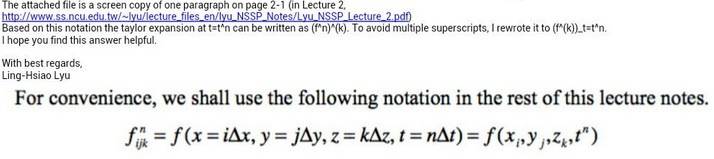

I spend some time with the equations but, there is still one thing I do not understand. What do they mean with
t=t^n ?
I wrote an email to the author of the text and got this reply:
But this does not really help me. I do not know what exactly this means. \Delta t is from what I know the step size "h" or (x-a) (this is the notation the english wikipedia uses in the article about the taylor expansion).
I hope that you want to help me one last time.
Have a nice day
It's just a notation convenience to write ##t^n## instead of ##t=n\Delta t##. He doesn't use it in lecture 2, but in table 3.1 he does -- in a manner that isn't fully consistent with his convention. But it's readable. Try to master 2nd order first by writing it out in full - if stuck, grab another textbook or pdf.

Ok. So I will try to go along the Taylor series notation of wikipedia right now:
so f is the same f as from the appendix.
\Delta t is the step size and is the same as (x-a).
So does this mean, that (f)_{t=t^n} is the same as f(a) ?
This would mean, that t=t^n is the position at which I evaluate my function.
Higher order Runge Kutta evaluates the function at intermediate points. E.g. for 4th order in the starting point (C.47), halfway (##\Delta t\over 2##) using ##f_1## (C.48), halfway (##\Delta t\over 2##) using ##f_2## (C.49) and at the end of the step (##\Delta t##) using ##f_3## (C.50). So: yes, in this case ##\Delta t## is the step size. But: no, the function is evaluated not just at ##t^n## but also at ##t^{n+{1\over 2}}##
Compare these to the notation in table 3.1 -- post if there is any doubt whatsoever left over.

I think I got it, but I just want to be sure:
When we take a look at e.g. C.53
we have f_4 = (f)_{t=t^n}+\Delta t (\frac{\partial f}{\partial t}+f_3 \frac{\partial f}{\partial y})_{t=t^n}.
If we just look at the beginning now; it means that I will take the value of f at the position t^n.
(while the function f_4 get's evaluated at the point t+\Delta t).
Is this now finally correct ?
I think you've got it !
