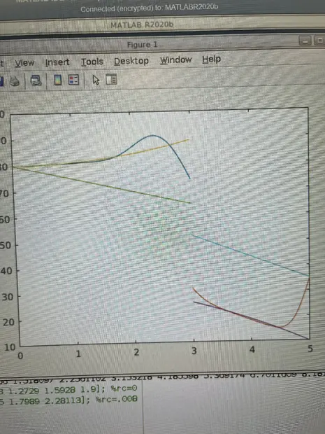

With a quick online search I see that most sources state that the boundary condition at the interface of two materials in contact having contact resistance is
-ksub1*u'sub1 = -ksub2*u'sub2 =q
usub1 - usub2 = R*q
I've tried to produce a solution consisting of two equations, each describing the temperature distribution in each material with questionable results.
Am I expecting to have one set of eigenvalues for both derived equations? Or does each equation have its own eigenvalues?

I followed what you said. I checked my solution over more than once.
I derived the solution for a non-homogeneous problem with the external boundaries at constant temperature.
I don't like the curve I have on the left. There is a weird hump in it. The image shows a graph from MATLAB at t=1. The curves overlay the initial condition curves which I picked a generic parabola. The straight lines below the left curve and above the right curves are the steady state with the contact resistance at a=3. All my material properties are random numbers I picked for testing.
alpha1 = .05
alpha2= .03
k1= 30
k2= 18
a=3 interface location
b=5
Rc=.08 contact resistance
u1(x,0) = x2 +80
u2(x,0) = -x2 +35
The temperature at the left boundary is 80
The temperature at the right boundary is 35
Does this seem correct based on a simple glance? I feel my left curve is wrong.

Looking at your MATLAB plot, I can see why you're concerned about the "hump" in the left curve.
Your setup has:
Left boundary: T = 80°C (constant)
Right boundary: T = 35°C (constant)
Interface at x = 3 with contact resistance Rc = 0.08
Initial conditions: u1(x,0) = x² + 80, u2(x,0) = -x² + 35
The "hump" you're seeing is actually physically correct and expected behavior. Initial condition mismatch, at t=0, your left domain starts with a parabolic profile (x² + 80) that has its minimum at x=0 with value 80, then increases as you move right. At x=3 (interface), u1 = 9 + 80 = 89°C. Boundary condition constraint, the left boundary must remain at 80°C, but your initial condition at the interface (89°C) is higher than this boundary value.
Thermal diffusion, the system is trying to equilibrate. Since α1 = 0.05 and α2 = 0.03, the left material has higher thermal diffusivity, so it responds faster to the boundary constraints.
I guess I see what you mean. So the heat is diffusing to left and right causing the hump I'm seeing with that left curve.
Exactly...the heat is indeed diffusing in both directions from that initial "hot spot" near the interface. The transient "hump" behavior is a classic signature of heat diffusion problems where the initial conditions don't match the eventual steady-state profile. It's particularly noticeable when you have a significant temperature difference between the initial condition at the interface and the boundary conditions.
