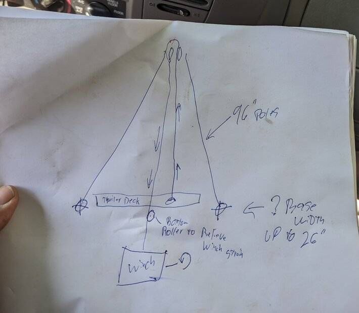

I am in the middle of building a dump trailer, mechanical lift with winch or a mounted lift points. For stability side to side I have elected to make the standing pole an A frame design. I need to know the best width at the base to use for load (comparing to a straight pole of equal size.
Let's say 2 poles standing straight have a max lift of 1000lb. This same 2 poles will have a max lift of ( ? ) if the base is 18" wide vs 26" wide. The lift points on the poles is at 96" (poles are 98", but I need metal remaining for bolts and welds)
So, how much lift strength do I lose to the A frame at those 2 widths. Thanks so much

A sketch, showing the dimensions of the tray, and the position of the axles, would be helpful.

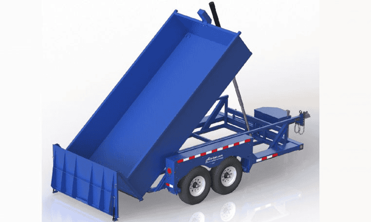

Something like this?
3D CAD rendering of a blue tandem-axle dump trailer with its bed raised at an angle on a hydraulic ram, showing the tailgate and frame.
https://www.platformsandladders.com/cartsandtrailers/air-tow-drop-deck-dump-trailer

Change helpful to necessary. Provide a sketch, or this thread will be closed. Everybody, please do not reply until this person provides a suitable sketch.

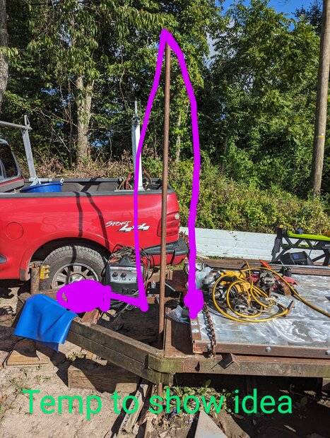

Ok, when I'm home I'll sketch out what I'm talking about. Sorry if my fumbling explanation didn't make sense

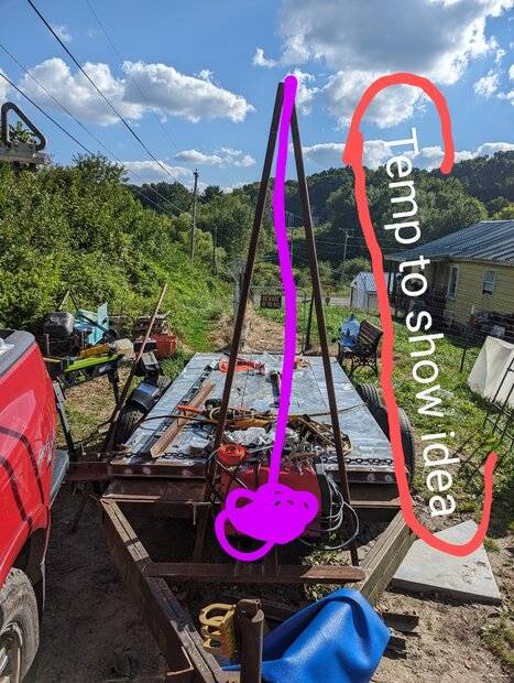

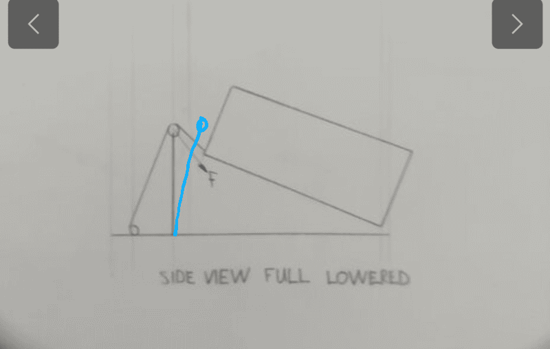

  • Hand-drawn sketch of an A-frame hoist with a 96" pole, a trailer deck across the base, a bottom roller, and a winch below with arrows showing the cable route; labeled "? Base width up to 26"".
  • Photo of a red Ford F-150 pickup and a flatbed trailer with a vertical steel post and a sketched magenta outline of a proposed A-frame, with green handwritten text reading Temp to show idea.
  • Photo of a flatbed trailer with a tall tapered A-frame of steel bars mounted on it, with a purple line drawn from the frame apex down to a coiled rope on the bed, and red handwritten text reading Temp to show idea.
Why not make the base of the "A" as wide as the trailer? And as mentioned, it looks like you should plan on a lot more cross-bracing. The more triangles that you can fill into the "A" the better, IMO.
Is the "A" only erected when you want to tilt the dump bed, or do you drive down the road with it sticking up like that?
How is the "A" base attached to the trailer? Via hinges, or something rigid?

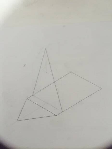

if the a frame design looks anything like in the following picture:
Pencil sketch in perspective of a tall triangular A-frame standing on a trailer base, with a rectangular deck or bed extending to the right and a braced section near the bottom.

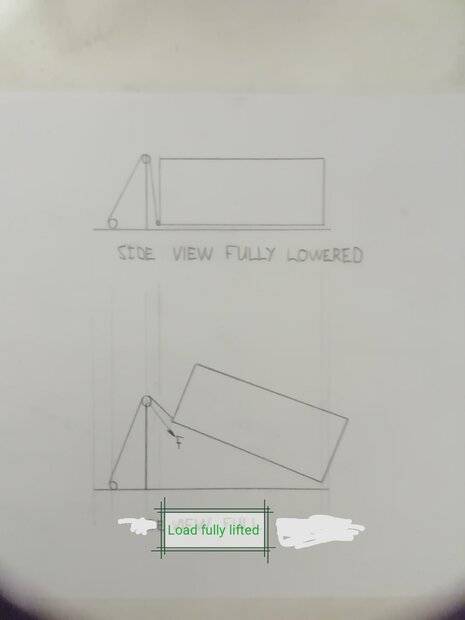

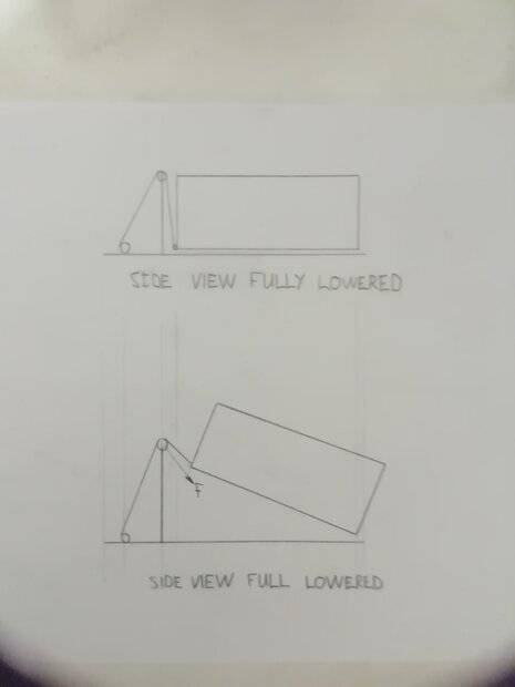

then i think you have two major conditions to consider. the first condition is when the load is fully lowered and the second condition is when the load is fully lifted.id like to draw your attention to how much the angle of the rope changes when the load is lifting.
the a frame is going to have significant bending loads on it when the load is fully lifted. if you have only designed for compressive forces then failure is likely to occur.
Two pencil side-view sketches of an A-frame lifting rig with a pulley at the apex and a rectangular load: top labelled SIDE VIEW FULLY LOWERED, bottom showing the load fully lifted and tilted up. Green label reads Load fully lifted.

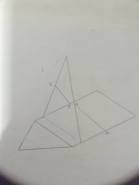

my suggestion is to forget about adding a third leg in the a frame and rather add braces in to support the a frame against bending loads. the following picture serves to illustrate my point.
Hand-drawn isometric sketch of a triangular A-frame with a horizontal rectangular base, labelled E, F, G and H, with a line drawn from the apex down to the base.
brace EF and brace GH will make your a frame much stronger than any third leg on the a frame itself would. of course there might be the slight inconvenience of the braces interfering with the load. but ill leave it to OP to figure that part out...
i dont know why my photos came out so blurry... apologies for that...

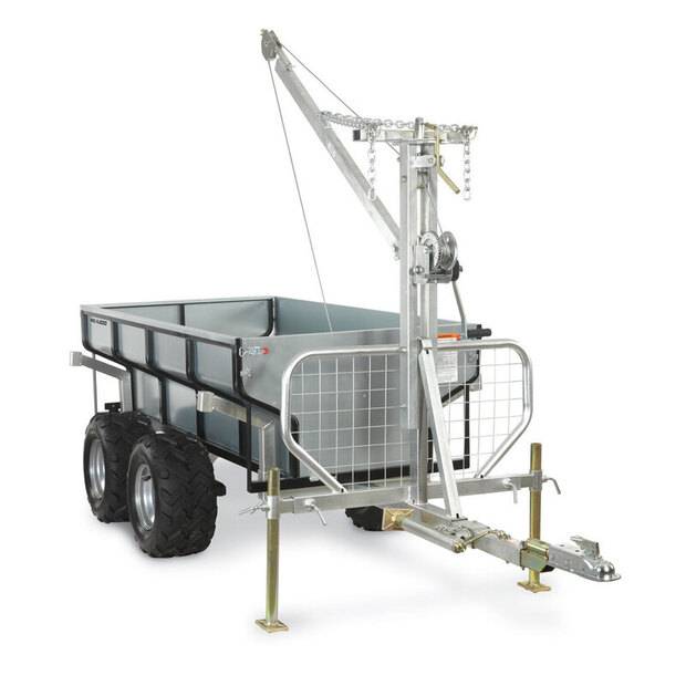

Please, take a look at this design, which reduces that problem:
https://www.drpower.com/Power-Equip...2dmzl29HUNQ6f6aU_IEOStP-95gdqdSBoCdgQQAvD_BwE
Silver galvanized utility trailer with a tipping steel box and a mesh front guard, fitted with a manual winch and cable mounted on a tall upright pole with an angled jib arm at the front.

Out to 28" there is a subframe under the deck for added strength. I'm going to add some cross members into the Aframe and it's going to be pinned at bottom so it can lean with the dump deck as it raises and to make it easy to pull off and store on the side of the trailer

The real effort will be at the base of your standing pole, due to forward and aft tension of the cable as the tilting angle changes.
https://www.drpower.com/Power-Equipment/Trailers-&-Carts/Versa-Trailer/DR-Versa-Trailer/p/VT15010TBN?gsa=true&ctm_id=VT15010TBN&src=AW1CA8EXE4263309&gclid=CjwKCAjw3dCnBhBCEiwAVvLcu8JgrMXLNHzMZNx9Df40zK2dmzl29HUNQ6f6aU_IEOStP-95gdqdSBoCdgQQAvD_BwE
The Aframe is getting cross braces and the bottom are going to be pinned to allow front to back lean to maintain correct angle and be easy to remove and store on side of trailer. Deck height is 30"+ 98" is almost 11'. Suddenly clearance in some spots becomes an issue. Easier to pop the frame off and stow it

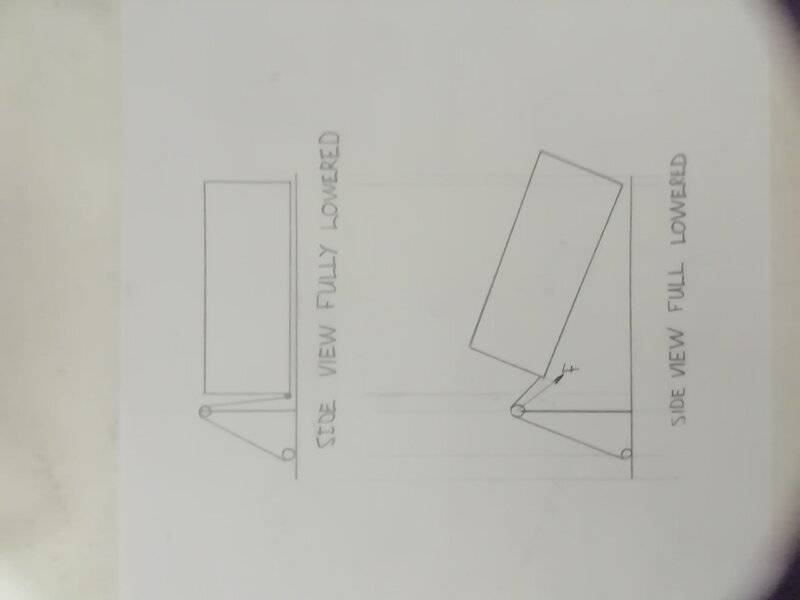

The frame has to pivot with the deck to maintain least stress on the system. I'm looking at pins on the bottom to allow that and to make it easy removal
Hand-drawn side view sketch of a tilting trailer in its full lowered position, with a triangular A-frame support on a pivot and a blue line tracing a cable run over a pulley to a point labelled F, on a horizontal ground line.

Twin axle, leaf spring with correct center pivot. The whole dump is being built as a removable unit on top of an existing trailer deck. The dumping deck will have only 3 connectors to the main trailer, 2 rear hinges and the front lift/lock down point.
The original trailer is very heavy and well build (ugly but strong) with a flat steel deck. Its odd to see a 5'x10' deck double axle w/ brakes on one axle. We believe it was custom sized for some specific piece of equipment as there is usually no need for 3500# rated axles on something this small. A 5x10 with a load capacity of 7000# is way overbuilt. I am going to be able to un pin the whole assembly, pick it up and drop it on another trailer frame or even a truck bed.
