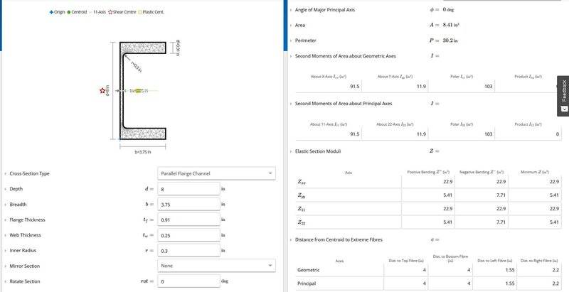

IdBdan said:
If I add the 1/2 x 3 1/2 to the top and bottom flanges I get a 91.5 MoI.
If that doesn't work I'll have a useless pair of $1500 beams and ..... well .... let's just say my neighbors kids are going to get a lesson in some very loud cussing.

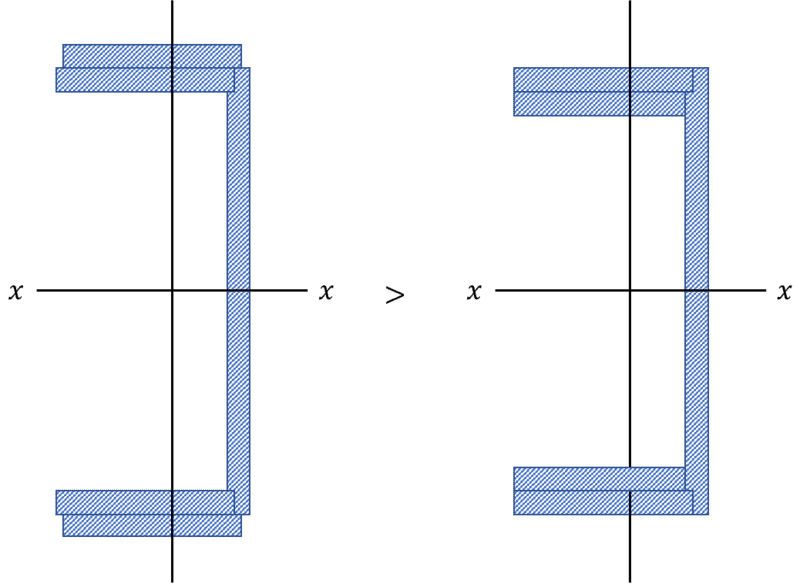

If the entire beam had a M.o.I of 90 in^4, the deflection comes to about 0.7 in. Is there some reason you aren't placing the 1/2" plate on the exterior faces ( top and bottom ) of the channel? It's going to get you more bang for your buck in M.o.I. increase.
Also, keep in mind that your frame should be more rigid than that beam once constructed. So the apparent deflection of the beam may not be as big an issue as it currently appears.
