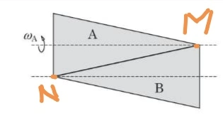

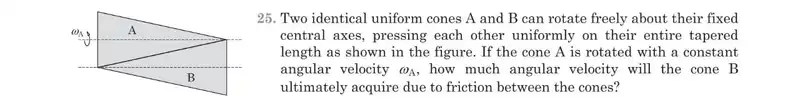

Two identical uniform cones A and B can rotate freely about their fixed central axis pressing each other uniformly on their entire tapered length as shown in the figure. If the cone A is rotated with a constant angular velocity ##ω_{A}##, how much angular velocity will cone B ultimately acquire?
Pic Below.
I know that friction will act on both the cones until there is no slipping throughout the length in contact.
Velocity at points M and N should be Zero in the end since
##V = ωR## and ##R = 0##
Total Angular Momentum of the system must be conserved since
##τ_{net} = 0##
But I'm not sure how to find the final angular velocity of cone B from here on.
Any help is appreciated!
Are you sure that is possible? Think about tangential velocities.
I made a mistake. The velocities at M and N can never be zero since it would imply that
##ω_{A} = ω_{B} = 0## which is not true. Thus there must be constant slipping.
There must always be slipping almost everywhere along the line of contact, yes.
I think there must be one point which is at rest where no friction acts. It is at this point that the directions of the forces change.
Using similarity of triangles and equating the velocities at those points, the vertical distance of the point from the tip of Cone-A comes out to be:
##Y = \frac{H}{\frac{ω_{B}}{ω_{A}} + 1}##
Where H is the height of the cone
The torque due to the friction on an element of length dl at a distance r from the axis is given by
##dτ = (μαdl)r##
Where ##α## is the Normal force per unit length which is a constant and ##dl## is an element of the total length
From similarity of triangles:
##dl = dr \frac{l}{R}##
##dτ = krdr##
Therefore ##τ = \int kr\,dr## with limits from ##0## to ##x## and ##x## to ##R##
Integrating and Equating both gives the value of ##x## to be ##\frac{R}{√2}## which corresponds to a height of ##\frac{H}{√2}##
Equating this height with ##(1)## gives the value ##ω_{Β} = {√2 - 1} ω_{Α}##
Which is the right answer.

The symmetry is illusory. In steady state, each cone has zero net torque, but only one cone has a torque applied at its axle.
In general, the torques they exert on each other need not be equal and opposite. If the equal tangential speed point is distance x (along the slope) from one end, out of a total length of L, and the frictional force per unit length is ##F## then the two torques are ##F\sin⁡(θ)(\frac 12L^2−x^2)## and ##-F\sin⁡(θ)(\frac 12L^2−2Lx+x^2)##. If the first is zero, as it must be for the cone with no other torque, then the second is ## F\sin⁡(θ)L^2(\sqrt 2−1)##.
